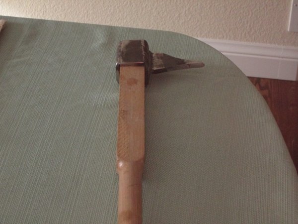

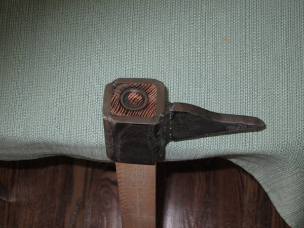

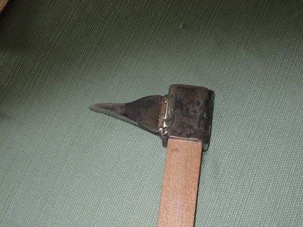

    You make another pickaroon.
    I had made one before but after looking at some pictures on here I decided to try a different design. This one it heavier on the pick end and it also sticks in the wood much better. I use a post hole handle because I got it cheap. The metal is just scrap from a previous project.

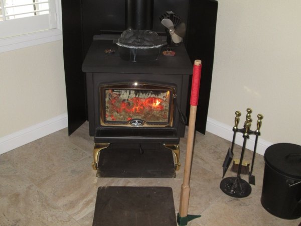

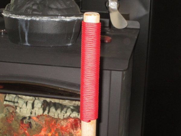

    So an update. Another day inside so I decided to wrap the handle with parachord. I drilled the wood for the ends to go into and I also put down a thin layer of epoxy before wrapping to hold the parachord in place better. Red just makes it easier to see.
