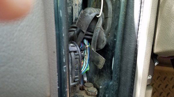

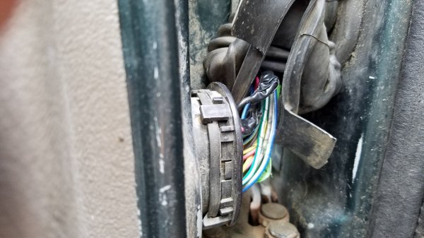

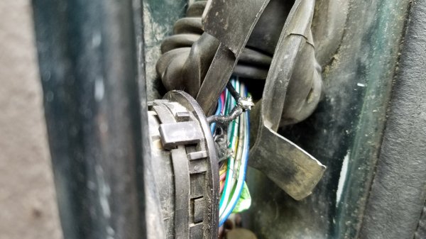

    Yep that's exactly where it is, where I fixed it last time, I can open the door and push or pull on that boot and get the windows to work
    Horkn and papadave like this.
  5. papadave
    Horizontal. That musta been the cause.:rofl: :lol:
    Horkn and thewoodlands like this.
  6. papadave
    One of these days, I'll need to pull the door panel and the boot to fix it.
    Horkn and HDRock like this.
  7. HDRock
    17,262
    60,487
    Last time I used a little propane soldering deal, I'm sure I didn't get it hot enough that's why it came apart , poor solder job, plus it was winter, plugged in the electric soldering iron, got it good hot this time, all fixed now windows are working:thumbs:.
    Cut a piece of hanger wire to hold the boot up out of the way.
    Shouldn't have to take the door panel off Dave but, there is not extra wire to pull out there hard to get up in there

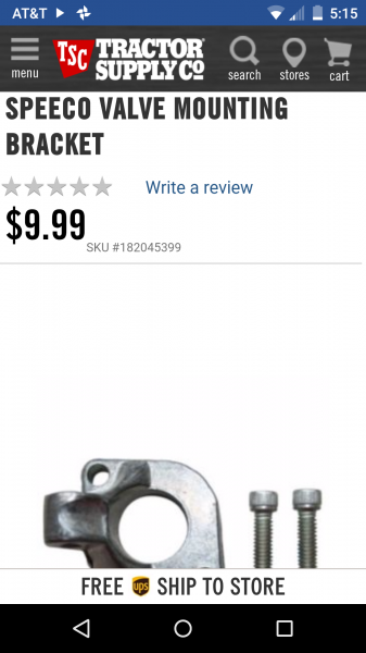

    Yes, confirmed this with our senior field service engineer. The bolt pattern is the same on these. Pretty much industry standard. So any of these you find will work. We don't have any laying around, otherwise I'd gladly send you a couple, and keep spares for anyone else.
    TSC, fleet farm, northern tool, all should have these on hand.
    Eric VW, HDRock and papadave like this.
  16. papadave
    Cool, thanks Horkn . I'm making a trip to the "big city" soonish, so I'll check TSC first. There's a Northern Tool there as well.
    HDRock, MasterMech and papadave like this.
  19. papadave
    Nice, but it's out of stock at my store.
    The upper mounting boss on that Speeco is thicker than mine. Maybe on purpose, eh?
    ETA: Just called the store in Gaylord, and they have one in stock. Might be a road trip. :)
