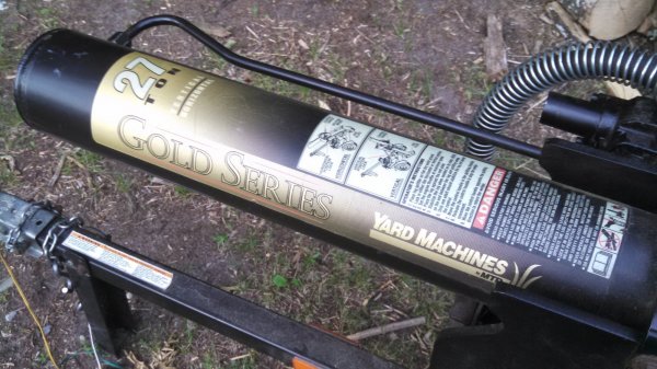

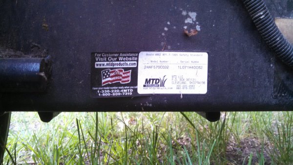

  9. papadave
    Thanks. Don't know what's local, so I may need to go the internet route.
    The valve is an Energy, and the splitter is an MTD "Gold Series".
    Horkn likes this.

  11. papadave
    Hey, those "Gold Series" stickers give it more powah, doncha know.
    I appreciate you checking Horkn .
    Shawn Curry and Horkn like this.

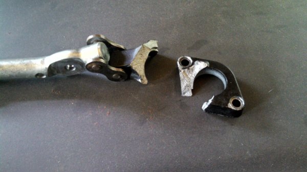

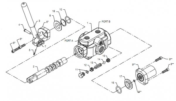

  15. Horkn
    29,160
    166,383
    papadave likes this.
  16. papadave
    Yep, that be the piece.
    Safe to just pull apart and replace needed parts? Is there any pressure there?
    Horkn likes this.
  17. Horkn
    29,160
    166,383
    No no pressure, provided it's not running. ;).
  18. papadave
    After dropping off the Jeep, I went out and pulled the bracket and handle....
    Links and pins all are in good shape, but I'll replace the cotter pin.
    ChipsFlyin, Horkn and HDRock like this.
