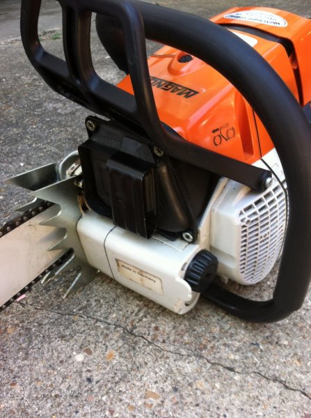

    Still sounds a little lean. Ever put a tach on it? When my 660 was stock it 4-stroked well around 13K with 93 octane at 32:1 mix. After porting, with the same fuel mix, it would 4-stroke 14K+. Although it's set around 13,600 rpms now. A dual port muffler helps a lot and also removing the entire baffle.
    DP Stihl 660 muffler
