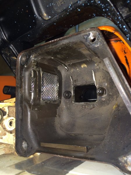

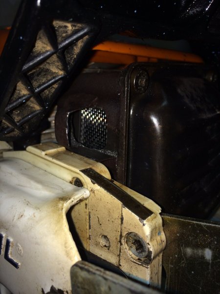

    Here you go. I did this a few weeks ago, before the rings.

    Get a new compression gauge, gut that muffler, start from scratch on the carb adjustment and make sure its 4 stroking, and she should cut. Has the saw been messed with or an attempt to port it by someone?

    That saw is deathly lean on the high side !!
    I suggest that you pull the limiters and tune the saw in the wood
    Sounds like you still have the baffle in the muffler too ........... they really wake up when you remove the baffle, enlarge the outlet, and tune it in the wood
