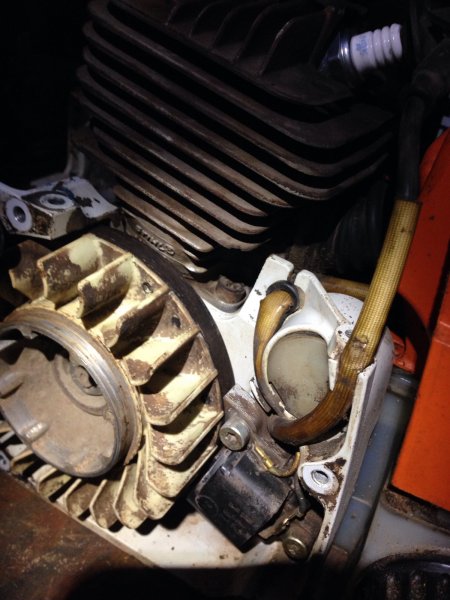

    Ok, someone let me in on the secret. How do I get to the head bolts? Find are in the way on each corner and its tight.
  3. JRSDWS
    JRSDWS
    475
    1,337
    Central Illinois
    There should be holes cast into the cylinder that allow you to go through the top. I can vaguely see one in the pictures just left of the spark plug.
    mdavlee and JoshC like this.
