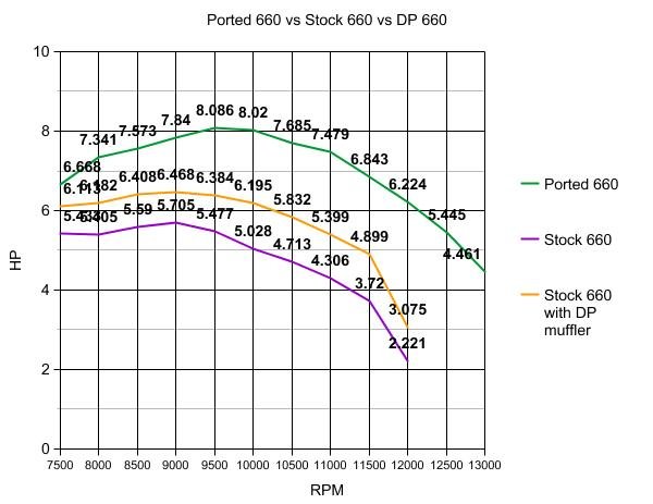

    When I bought my 660, with a 28" bar, I didn't have any bogging issues and it seemed powerful. The factory WOT was as 12440. I later added a factory DP muffler and set it at 12880 which seemed to be 4-stroking well. After joining a few chainsaw sites I decided to have it ported. After it was ported it was a significant increase in power. Now, with 93 non-E fuel at 32:1, it 4-strokes well at 13,900 rpms+ but I set it slightly less. The guy who ported my 660 said it came with an excellent jug. The saw was later put on a dyno to determine max HP. The guy with the dyno also put his stock 660 on the dyno to determine factory HP. The factory 660 HP was not to factory specs and is only around 0.5 HP more than a stock 372 if the Husky HP specs are correct. Stock 660 HP only showed 5.7HP (factory specs says 7.1) and the 372 stock HP, factory specs, shows 5.3HP. That might be the reason you're not seeing much difference. Adding a DP muffler increased the HP over 0.7HP but after porting it increased the HP to 8. Here's the dyno chart to show you what I mean.

  11. Evanrude
    Evanrude
    Nov 24, 2014
    267
    752
    Byron, MI
    Ron, I've seen that graph before and it's very impressive! The big question is; how thirsty is she now? I hear ported 66's like a lot of fuel.
  12. Ron660
    Ron660
    Aug 25, 2014
    177
    445
    NW Louisiana
    It definitely likes the fuel but I don't cut a lot so it's no big deal.
