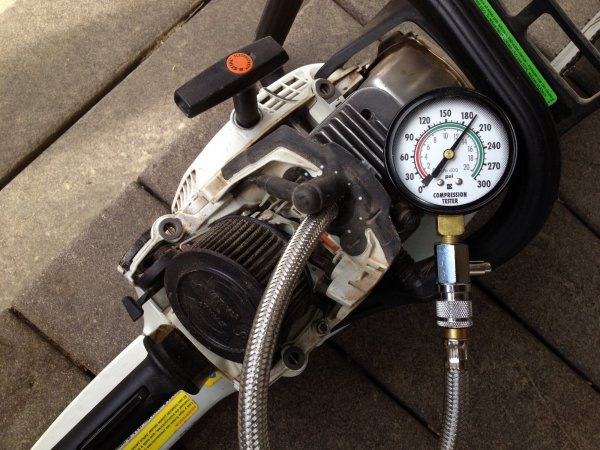

    Whooooeeeeee that saw has been hot. Def sounds lean in your vid and the plug confirms it with all the fluffy deposits on the plug. I'm betting it was run hard on oil not designed for air-cooled two strokes (ie. outboard/marine oil).
    If it was mine, I'd give it a meteor piston kit and a bath. ;)

    A bath is certainly in its future. I'm going to start with a good tune up-plug, air and fuel filter and some fresh gas. I'm still on the gas he had in it. After that I'll run it a time or two and see if I notice anything. I'm starting to think the rings are probably about shot too. But I'll put some Teflon tape on my compression fitting and test it again.

    Check to make sure the o-ring on the fitting isn't blowing out to the side. I degrease mine occasionally w/electrical contact cleaner and have to make sure it's tight for saws that will blow over 160psi.

    How many times did you pull it over? Did you keep pulling it over until the gage stopped?? Is the decomp stuck down? Can you pry it back out?

    Yes I pulled till the gauge quit. I can't tell what the decomp is doing. I didn't want to pry on it if it was out. I'm reeeeeally wanting to get that plastic off so I can investigate further.

    I've never had a 660, but I'm thinking that your compression should be around 150. Here's my MS261. :)

    A healthy one is 165-170 @1k ft or less elevation
