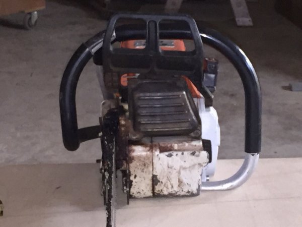

    This 460 was running an 8 pin with a 28" semi skip square ground chain. I'd say you'd be fine with an 8 on it.

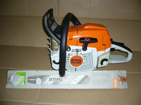

    Awesome 362??? Ohhh yeah!!!

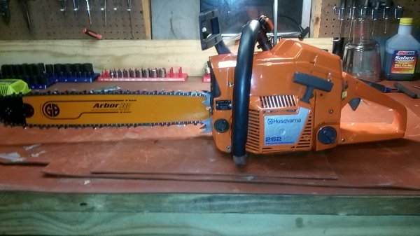

    Yep my ported 362 is pretty awesome but we will see what this ported 262 runs like tomorrow

    Ooohhh.....that's gonna be a bad mofo.

    So much orange :drool:
    Thats a purrdy saw :thumbs:

    Id like a black Cannon for it but $$$$$. That GB was only 32 shipped. Thats 18" bar with square filed chain

    Very nice. Sounds like a great combo :drunk:

    looks great, Keith!! :drool:
    Wait... Who ported it? Ive got to get my 262xp up and running. And Ive got an appointment for June 17... I just gotta decide what saw to send! Mebbe a 262 :thumbs:

    Lol! I ported it myself. Cut the squish and deleted the base gasket and raised the exhaust and the transfers a bit and blended lower transfer lips toward bottom of cylinder but left intake where it landed after deleting base gasket. About 178psi on compression so far with very little run time. Compression may rise a tad when rings seat . Bottom end seals still pretty tight.

    Keith, I hope you didn't make it faster than my ported 036 or I'll be bringing it back for more dremel work!
