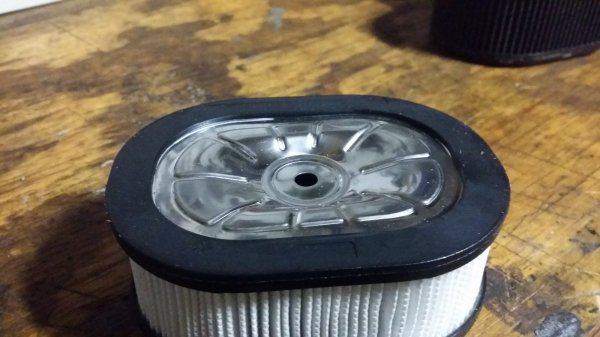

    Like this?
    Those are aftermarket filters. I don't have any exp. with that particular one.
    That's just it. The 660 suffers from being modified to meet emissions standards that are much tighter now than when the design debuted with the 064/066. Take a good look at it and notice the baffle inside the muffler and the ridiculously tiny exhaust outlet. Twin transfer port engines on a Stihl like to breathe. Which is why the MS440/460/660 all respond very well to muffler mods. (Note: the 440 has a larger exhaust outlet than either of it big brothers. :loco: :crazy:)

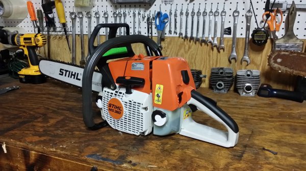

    I have personally had a MS 360 with an intellicarb that would bog under load. Had an OEM filter and several seen it run at the GTG at Swags in May. Revved like a mad man. But once in wood? It lost all power. Took me a month of testing to figure it out. I put almost $600 in that saw and racked my head over what was wrong
    Had new Everything.. Except the air filter.
    The filter had been blown out, but after years of fines, it was just "plugged" up.

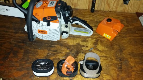

    That is a different animal. Yes..
    But some have not upgraded to that system and an Original HD filter with Prefilter can and will "pack" the same as a flock filter.
    And these Chinese White pleated filters are even worse than the original flock filters. Having ran one side by side? I pulled it.. And will ship it someone for free.
    Kg461 and raybonz like this.

    that;s not the same filter that mech posted. mechs is like a white K&N or a stihl HD#whatevernumber now.
    I still run the old HD filters. the second gen ones, like your pic above. most have probably never seen the first gen HD filters, looks strangely like the latest, but was metal instead of plastic. anyway, I run the last gen filters that have worked for 18-20 years. Why?, because they work, and I have '8-10 of them. 50 bucks is much better spent these days. I'm talking about abuse here, not regular cleaning out of filters. Milled some serious sized lumber, like 2 tanks per cut and an air cleaning because its so packed. I thought I had seen "dirty" filters on my 046/440/044/066/660's in the past, but nuthing and I mean nuthin' like one 10' long 28" wide mill cut. Point is, so packed, the saw still ran with every ounce of body weight to advance the saw down the board.
