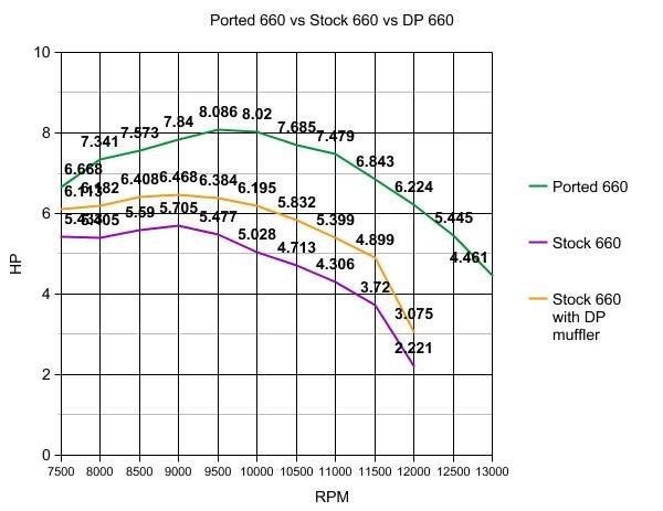

    I think it was even well under 6hp according to Chad's dyno sheet. The dual port put it back up to roughly 6.5 or so and the factory HP spec is listed at 7.0. :loco: :crazy:
    Oh yeah, here it is...
    http://firewoodhoardersclub.com/for...orted-660-vs-stock-660-vs-dual-port-660.6007/
    Also, the problem isn't just in the restrictive mufflers and lean tunes. There is a reason the early cylinders are sought after items by guys building these saw's.:sherlock::dremel:

    chads dyno doesn't do tq readings does it? Torque is what makes the chain cut, Hp is what keeps the chain spinning, it would be interesting to see the tq curves between those same saws. that chart is deceiving to people that don't understand how hp is derived from torque and some people would look at that and think dawging a saw in would be faster than letting it cut based on HP/RPM on that chart, but we all know that isn't the case.

    He gets the torque and then calculates hp.

    You can buy an aftermarket dual-port muffler for under $30.
    Some are treating HP and torque as two separate things in this discussion. (Steve, I know you understand ;)) HP is simply a mathematical conversion of a torque reading at any given RPM. Chad's dyno outputs a torque reading from a load cell (scale) which he then converts to HP to compare against factory specs.
    (To clarify for those that are learning right along with me)
    Torque is a measure of (rotational) force.
    Horsepower is a measure of work.
    Go to the nearest wall and push on it as hard as you can. You have exerted force on the wall. If the wall is still standing, you have made 0 HP. If you had a different result, please post pictures. :D
