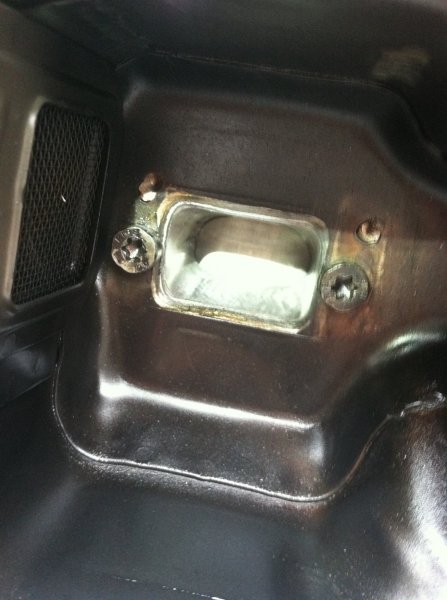

    Baffle removed

    Without spending a dime, you can get more out of that saw. Follow Moparmyway 's suggestions on tuning that carb (including pulling the limiters.)
    Pop the muffler halves apart, and take your favorite drill/ Dremel/ Unibit/ whatever and have at it.
    Re-assemble, tune, and go find some bigger wood for it to eat. If you can rebuild that old Ford dumper, you can make this thing run much better in about 10 minutes of your time.

    Oh ya! U can wake that 660 up just by modding the muffler . And porting it will bump it over 8hp

    Its interesting to see that when you install a muffler that isn't restricted on these saws, that power pretty much comes right back.
