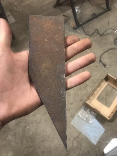

    I just did some digging I don’t have any 2*1/4 flat but I do have a huge sheet of steel that’s close I can cut them out of. No idea where I got it but I’ll do it tomorrow.
    I think all that’s left is tailgate, fenders and lighting then paint. The lighting will take a while to do but the rest is a few nights and done.

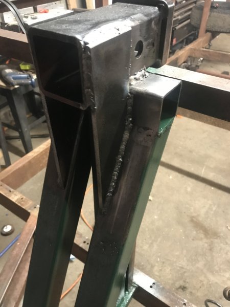

    Cool. For your gussets, 3/16 would work, but don't go thinner. I don't recall your winch rating, but it's gonna cantilever and create some issues if you're yanking heavy stuff (#1000 lbs. +) I think you're good to #1000 with this set-up, straight line pulls. The cantilever situation is my only concern, the rest looks good.

    Nothing crazy puking the splitter up in, occasionally an atv or riding mower. I’ll weight and see if I can find 1/4 drops somewhere close to me... There is a tooling shop in town they might have some.

    Just found that gem in my scrap! Time to make gussets!!! heavy as it can get!

    One down
