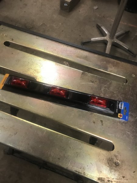

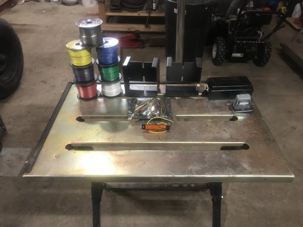

    The rest of the amazon goodies showed up today!! Just leaves fenders:Dand ramp hinges:D

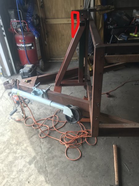

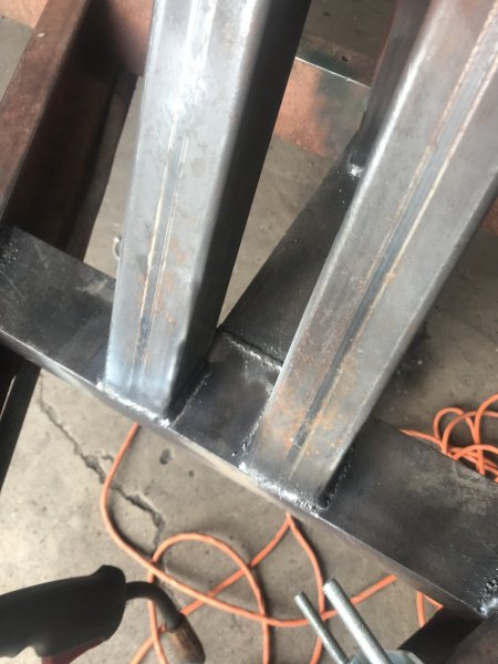

    Well this is what I am coming up with so far. Half welded half mock-up. It is free standing off the front of the trailer.
    I’m trying a new flux wire out and it is complete crap... I can barely strike an arc let alone keep the pool moving I may be taking it back and going back to forney E71T-gs good as Lincoln or Hobart wire and cheaper.
    The new wire just plain looks like crap... I had to fill a few very large gaps and grind down two welds then fill again do to that wire o_O

    Well so went to farm and home and picked up more forney 035 flux what a difference that makes... looks so much better!

    It’s almost ready and crazy strong!

    Definitely looks like better welds.
    Quality materials definitely make for a better outcome.:yes:

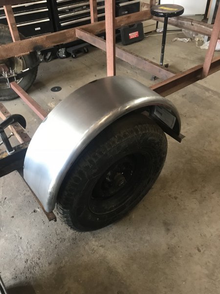

    Mocking up fenders now!

    You shouldn't mock your fenders, they'll help keep slop off your logs.

    You think that top square tube will hold? Thats the one thing I dont like on the winch stand. I am thinking about boxing the ends for strength.
    Horkn, Chvymn99, Chaz and 1 other person like this.
  15. Beetle-Kill
    Beetle-Kill
    Nov 23, 2013
    4,102
    19,559
    Near the Divide, Colorado
    Box the ends, and run a gusset plate from the back of the receiver tube to the diagonal supports, one per side. Some flat bar will work fine. Should spread the force and not have that cross tube want to "rock" under load.

    I like it! I have some scrap left I can make gussets out of.

    Yeah, a couple pieces of 1/4 plate welded on each size would make that rock solid!
    Like this...

    Yes!!! Exactly what I had in my mind. 2 x 1/4 flat would be perfect. :yes:
    Allows lots of vertical weld strength. Perfect.
