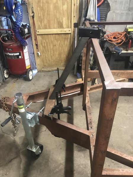

    Mocking up a winch mount right now so I can use it with either the truck or trailer.

    I really like the winch mount idea, very nice. :yes:
    I had thought of mentioning recessed tie down points on the new floor, but not sure that it would be tough enough for what you may be loading/strapping down. An ATV is much different than a healthy load of logs.

    19,559
    Near the Divide, Colorado
    That set-up may limit you. From the end of the receiver, how much of the winch is hanging into the trailer space? What angle is the cable when you have a log hooked up? What sort of gussets/supports are you adding?
    I'd prefer to see a vertical support for the main winch mount, two angled braces for each frame point @ the base of the side rails, straight brace from new channel cross to front frame cross, and a brace from vertical support to side rail (front). And the vertical should be .250 wall min., .375 better.
    Don't mean to be a buzz-kill, but it's better to build it heavy the first time.
    *disclaimer- PP isn't an idiot, but a lot of the people I deal with are. So we tend to build over-kill.

    I’ll put another pic up in a little while I haven’t gotten back to the trailer yet. The winch setup is going to be much stronger....
    That’s just the beginning of what I mocked up I spent another hour doing the rest I didn’t get a pic though...
    The scrap on the tongue has a piece going to the front of the trailer then a vertical support up to the winch support to hold the downward pressure. It’s got to be able to hold the splitter weight and any other random items maybe even logs getting pulled into it. I am attempting to avoid attaching it to the rail at all.so far it’s all 2*2 1/8” thick tubing.
    I like the idea of two more side supports to stop it from moving sideways at all....
