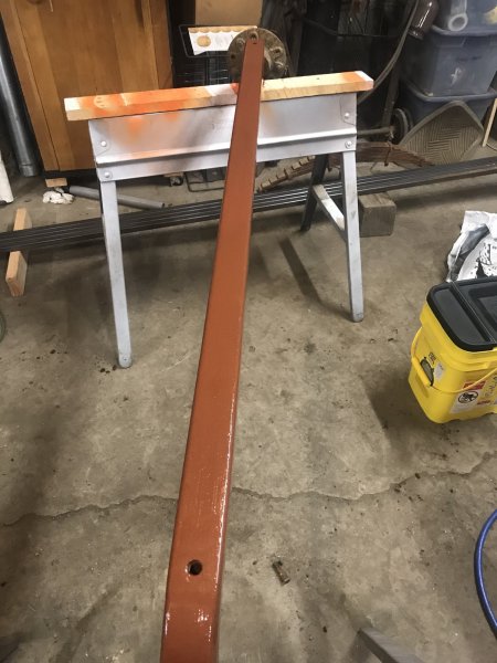

    I’m a huge fan of rusty metal primer and have used it with good success over the years on everything from cars to diy builds but the favorite by far was a log splitter that got totally rebuilt and painted so that’s what the axle is getting after a good wire wheeling and wipe down.
    Can’t do much today so I am hitting the axle with a couple coats in preparation for paint.

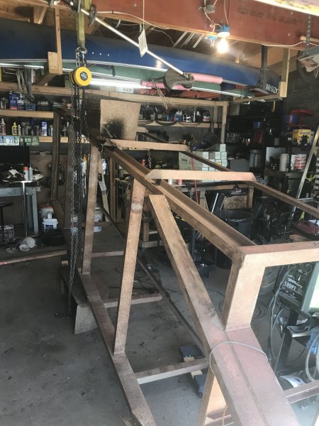

    Finally a warm day to really have at the trailer it’s almost ready for the springs! I’ve got brackets on one side welded up so tomorrow will be the opposite side then get the springs bolted on and trailer hauled outside so I can get the gate welded up.
    The wheel wells where welded on to stay! Man that was a lot of grinding to get them off:hair: the trailer.
    I’ve also got to figure out what to do for wiring protection the tubing that was on the bottom was collapsed in and rotted through in a few places.
    I’m debating using pex to run the wires through to act as protection it would allow me to run it almost anywhere I wanted.

    In regards to using Pex for the wiring, find out if it is uv resistant or not. I had some leftover from water lines in the house and used some to cover a cable for a kids swing. It became brittle and cracked surprisingly fast.

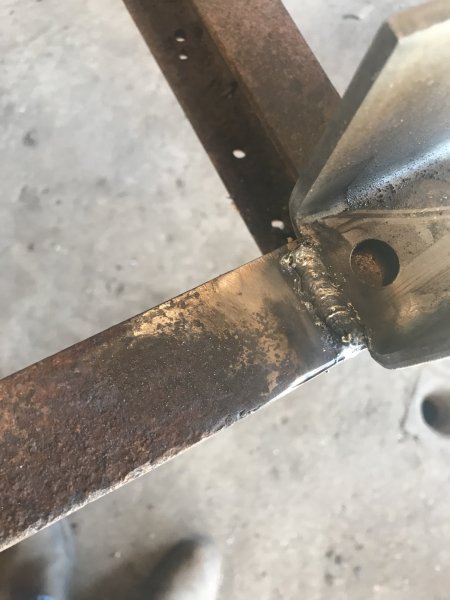

    This some VERY hard to clean and weld on metal UGLY! But it’s on there...

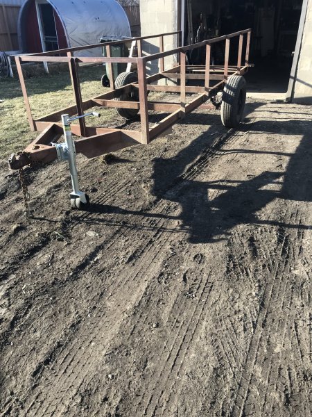

    She just got axles and a bath!

    I am attempting to figure out where to put the tie downs at. There isnt really a good spot on the trailer for them. I think maybe along the bottom of the c channel outside of the bed would do ok. and then some recessed in the bed.
    What do you guys think?
    They bed is about 52" wide...

    you could use 1/2 black pipe and weld it to the frame....that what I did.
