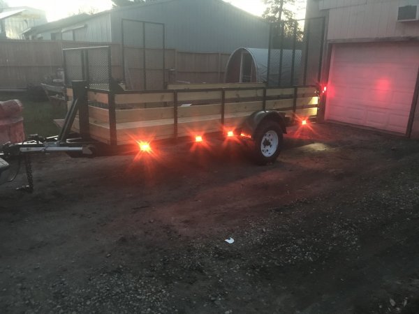

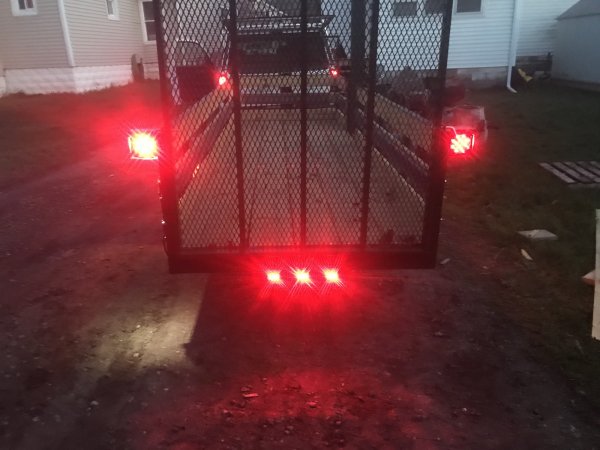

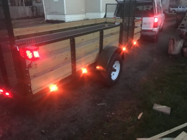

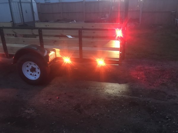

    Just rewired the insane rats nest under the truck so it has a proper 7 way anchored under the bumper now too. Took 2 hours to map it out re run and hook it all up again but it looks great now!

    I have GM tech books for the truck and believe me I needed them. There was a towing kit installed from the factory which is the easy part... Then some one along the way spliced into the aux and brake lines and ran the wires into the bed but left them unhooked. The 4 way had 12 splices in the wires that needed to be removed and non of them where the factory wires... Basically I had to redo the brake wire, aux, lights, brakes, ground and remove a ton of splices.
    It’s all wired from the engine compartment back to the bumper now. Properly wired with correct color code and no splices.
    I also had to remount the trailer harness and connection box. I forget what that junction is called but it was flopping around under the bed.
    It’s far cleaner and much easier to fix later if need be. A short term headache I guess....

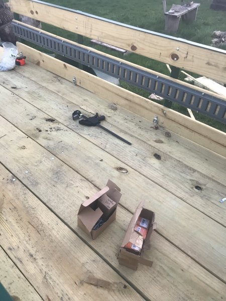

    Got a good deal on Etrack finally!!! $60

    I hadn't heard of Etrack before, did a quick Google on it. Looks like you can attach quite a few things to that track.
    That will be extremely convenient.:yes:

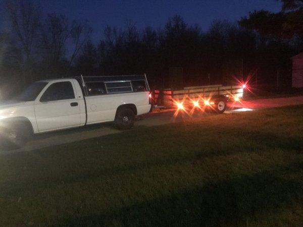

    Well 30 minute road trip and not a single issue! Hubs are nice n cold too...
