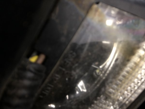

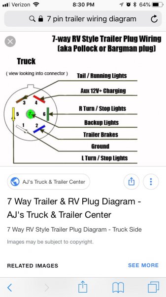

    According to the diagram anyways red, brown and yellow. I’ve never seen that before. It’s always been two wires....
    Chvymn99 and Horkn like this.
  2. Pallet Pete
    Pallet Pete Moderator
    13,483
    54,125
    Ovid
    Aha! Ok so it’s just like a 4 way then. :salute: Good grief the diagram for a seven way shows red as stop lights, yellow as turn.
    So yellow is stop and turn correct?

    Looking at the three wires hanging from your light
    First picture after wiring questions
    Brown to brown / red to red and yellow to white on left side and green to white on right side.
    Should be correct

    Thats not what the wiring diagram is showing

    Yes, but that original diagram is also showing a completely separate brake light in its own housing, which I don’t think is the case with Pete’s trailer. I think that particular wiring diagram may be the issue, and is causing the confusion.

    Red is stop so that must be yellow from the trailer.
    Brown is tail lights ( running )
    I think the diagram is not correct. Talk about annoying...

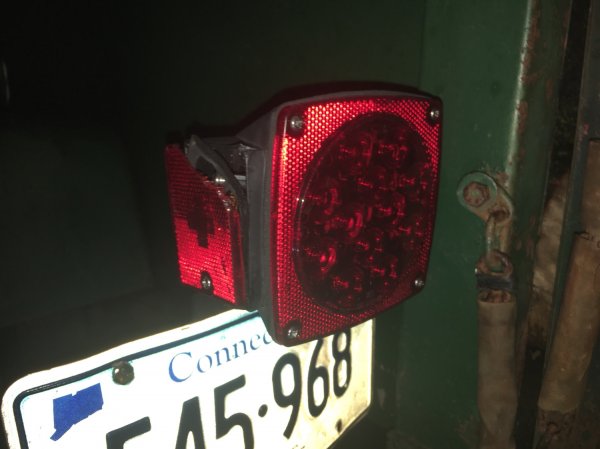

    Shouldn’t. Just took a pic of mine. Looks like very similar light to yours. These are LED. It’s a four pin, but that really shouldn’t matter as far as the lights go in terms of wiring. Sorry for the pic quality. It’s dark out.

    Green trailer eah! :startled: They do look the same! Creepy.
    I’ll try to wire it all up tomorrow night I’m beat.
    Thanks everybody! Pretty sure that diagram is the problem:whistle:
