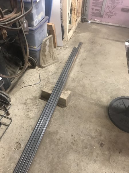

    Managed to get to Saia Fabricating today to get some metal for my tailgate. Talk about good prices!!
    11 guage 1*1 square tubing.
    Big name steel company near me $197 for 50ft
    Scrap yard $.60 lb VERY VERY rusty new metal
    Saia $55 for 50’

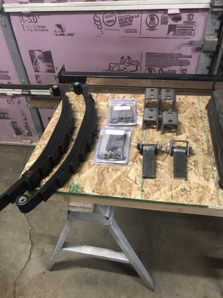

    Well I’m tired of hunting I made an impulse stop at a trailer sales place today while I was on my way back to the shop and to my surprise they actually had springs at a good price! 7000lb springs 3500 each lbs each.
    Pics coming all in all under $200 for everything!

    Here’s the haul. Really crappy hinges... They go back...
