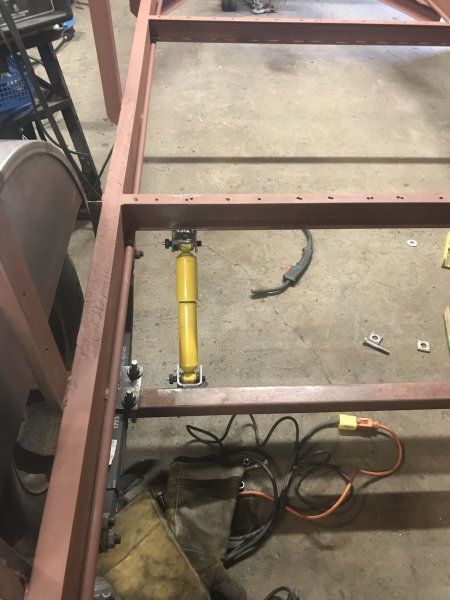

    Well ( knock on wood I don’t get called In tonight ) I will have the shocks finished. Little crooked but o well no biggie.
    I wish I could have mounted them straight up and down but that’s not happening so the next idea was this. It appears to work still.

    looks good, I do not think I have ever seen a shock mounted straight on a car rear axle, usually one front and one rear of axle too..

    Oops to late now:rofl: :lol: both front. I didn’t think about that :whistle:

    Fox body Ford's. If you're talking rear wheel drivers. I'm sure there's more than those though.

    It's fine. I wouldn't worry about it.

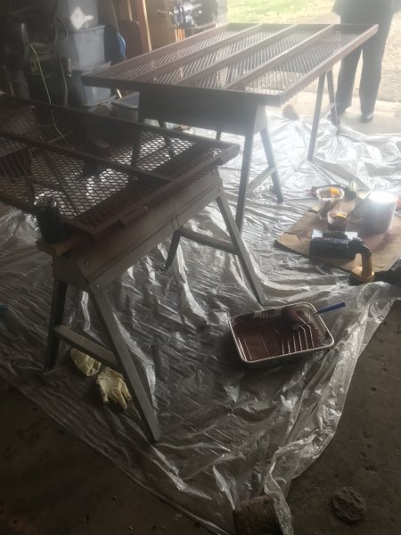

    Not a great pic but it’s all primed. A69D8920-82D3-41AC-94DF-E286FEE9B227.jpeg EDC2E325-D0C3-4B0D-B018-AC03CC7A0C1A.jpeg

    Thanks guys for the 3/8 nap roller idea that works great on the expanded metal!!! It takes work but much safer and less waste than spray bombing the metal!

    Off road edition...quad shocks...:D

    Ha! I like it!!!!! This trailer is fricken wearing me out!:rofl: :lol: It better be a good name like that to make the effort worth it! :rofl: :lol::rofl: :lol::rofl: :lol::rofl: :lol:

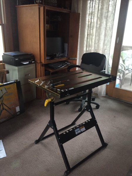

    Looking forward to the finished product Pete! BTW my HF welding table showed up yesterday at 5PM and i assembled this this AM.. Very good quality for the money spent! Thought the instructions were easy to follow and I only tightened by hand until fully assembled.. It is definitely the best bang for the buck! BTW the to edge guides checked out perfectly square with a 2' square! That's a big assembly plus!

    I think that table is also sold under a few other names. My friend has an Eastwood branded version that’s identicle aside from paint. It’s a well made table... I’ve used mine heavily and it holds up well! Every now and then I use PB blaster to clean it up and that helps a lot.
    Enjoy it Ray!
