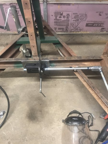

    Junction box and emt going in tonight!
    papadave, Horkn, eatonpcat and 4 others like this.
  19. Pallet Pete
    Pallet Pete Moderator
    13,483
    54,125
    Ovid
    That EMT looks great on there! I mocked up both sides took it back off and painted the junction box mounting plate not much else to do till tomorrow now. I might mount angle on the back of the beams for the bolts but I don’t think I have enough left. :whistle: We will see. If the emt is all then I will be cleaning the frame this week and painting it this weekend.:dex:
