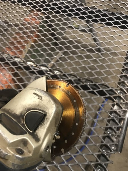

  4. Pallet Pete
    Pallet Pete Moderator
    13,483
    54,125
    Ovid
    My friend never showed up with his plasma cutter last night so I went and bought a diamond cutoff blade for the grinder. I love the one on my chop saw so why not. This thing is amazing!
    You NEED a guard with it but so far so good.

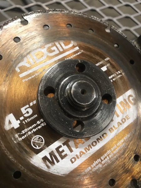

    Does your angle grinder use depressed type discs like my Ryobi does? If so how do you mount a flat blade\disc?
    savemoney likes this.
  6. ironpony
    ironpony
    3,778
    21,208
    Mid Ohio
    you need to use a different nut for flat discs, I am surprised you did not get one with the grinder, most can use both type
    Pallet Pete likes this.
  7. raybonz
    raybonz Moderator
    4,225
    9,758
    Carver, Mass.
    I will take a look and see if i am missing something.. I had to make a shim washer to use the .045" cut off discs... That worked great!
    savemoney and Horkn like this.
  8. Pallet Pete
    13,483
    54,125
    Ovid
    This. I’ve got a two way but for both flat and raised with mine. Flip it for raised and use the flat side for flat
    brenndatomu likes this.

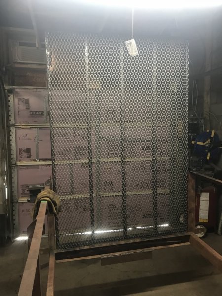

  9. Pallet Pete
    13,483
    54,125
    Ovid
    There is the bulkhead! Finally! No more expanded welding:dex:

  10. raybonz
    raybonz Moderator
    4,225
    9,758
    Carver, Mass.
    According to the manual the bottom disc has flats and must always be used in one position.. I still have the manual and the plastic storage case that came with it.. The depressed center discs are readily available so this is what I've been buying including the Black Hawk cutoff discs but they wouldn't clamp due to the .045" thickness so I bored out a flat washer and ground the OD to match the adapter OD and that works great.. The manual mentions nothing about using flat discs..
  11. Pallet Pete
    13,483
    54,125
    Ovid
    That’s the reversible but on mine. I’ll use flat discs all the time. image.jpg

  13. raybonz
    raybonz Moderator
    4,225
    9,758
    Carver, Mass.
    I just checked and the bottom spacer will not work if reversed just as the manual shows.. I've had this a long time and maybe they changed the design? Not really a problem anyways but thought I'd look and see if I missed something..

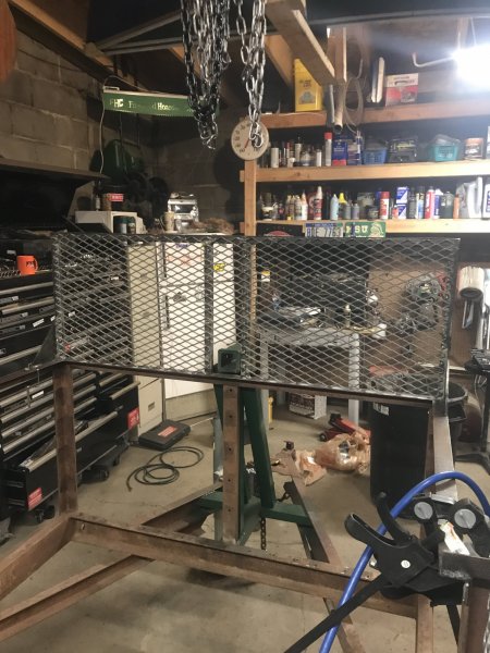

  14. Pallet Pete
    13,483
    54,125
    Ovid

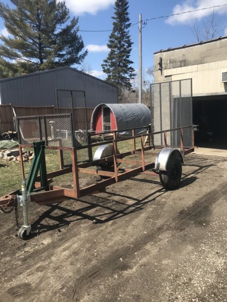

    Heavy but awesome!
    0620029F-ED80-45CE-8DE7-6CDC0D53C7FE.jpeg 9F629CF6-28FD-49D1-88A4-7A05221BDB0F.jpeg

  18. brenndatomu
    25,302
    164,722
    From $80 up to $200....hmm...they musta realized they forgot to include the extra 100 lineal ft. for the ramp(s) ;) :p :rofl: :lol: :salute:

  19. raybonz
    raybonz Moderator
    4,225
    9,758
    Carver, Mass.
    Gotta say that thing is coming out awesome! Probably holds close to 2 cords! Great work Pete!
  20. Woodwidow
    15,591
    95,991
    You are going to need a winch to get the ramps upright! Looking good though.
