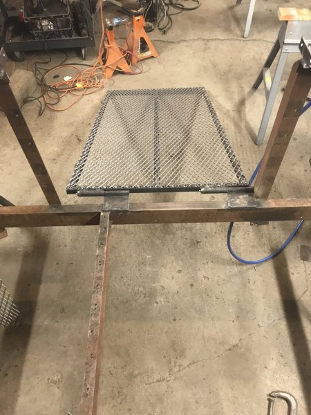

    so both gates are removable??? that is nice I need to modify the trailer I bought so I can remove the rear gate, would help unload some times.

    Yup they come off easy! All you do is pull the gate pins lower the gates a little and slide them off the side of the hinge.
    It’s a bit hard to do one handed but you get the idea.

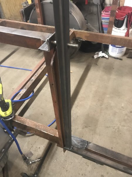

    Starting the fun part..

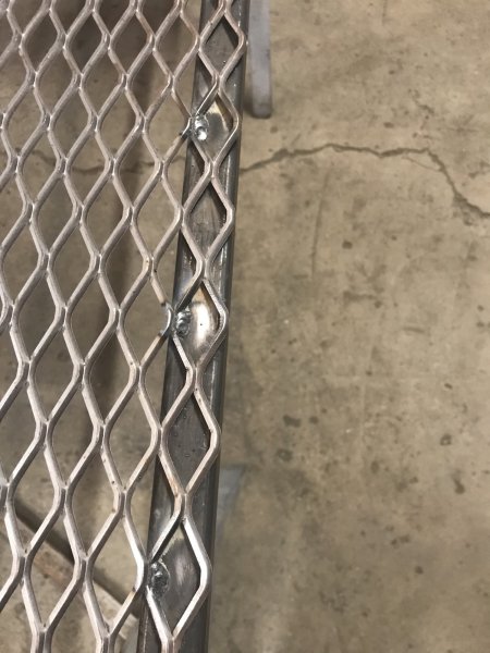

    Welded every other link it’s good and strong! I don’t think it will need every link!

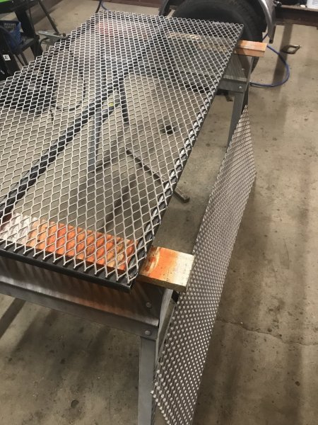

    Side ramp done!
    papadave, savemoney, Horkn and 5 others like this.

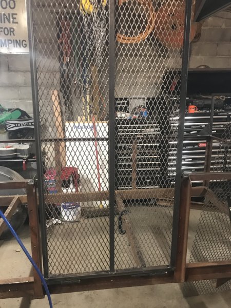

    Tomorrow will be the bulk head and back ramp hopefully... If all goes well...

    Maybe a couple of 1x1 angles horizontal and split the expanded metal into thirds, rectangles, stop it from bowing down under weight?
  13. Pallet Pete
    Pallet Pete Moderator
    13,483
    54,125
    Ovid
    I was considering something but I’m out of 1*1 I’ll have to get another 12’ or so..

    I thought I was done but nope burst of energy!
