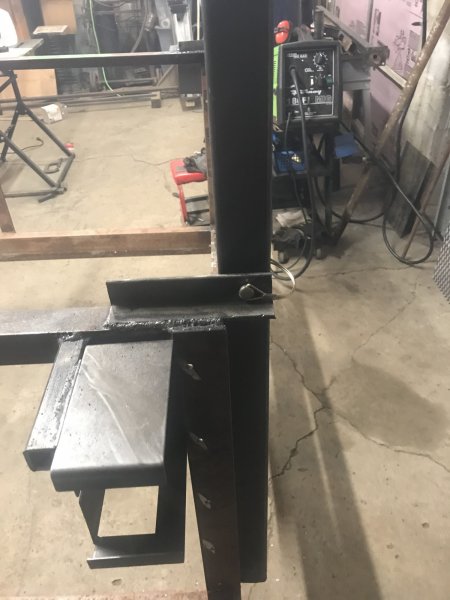

    Trailer pin holders welded in tonight.

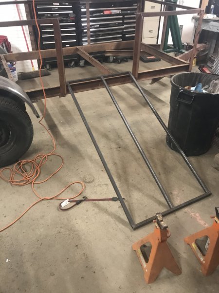

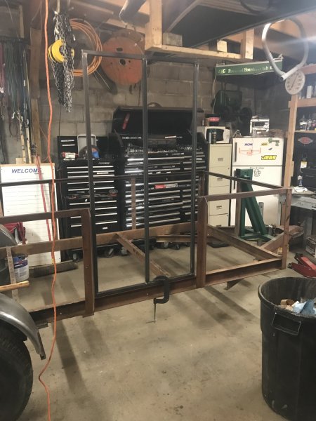

    Getting ready to start the side ramp.
  5. Pallet Pete
    Pallet Pete Moderator
    13,483
    54,125
    Ovid

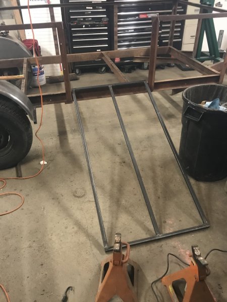

    It’s mainly for rounds so it’s 1*1 and doesn’t need to be as strong as the back gate.
    Mocking it up now.
  6. Pallet Pete
    13,483
    54,125
    Ovid
    All welded up

    This is turning into a pretty nice drawbridge house build!:Dalmost finished with it!
    Chaz, raybonz, savemoney and 5 others like this.

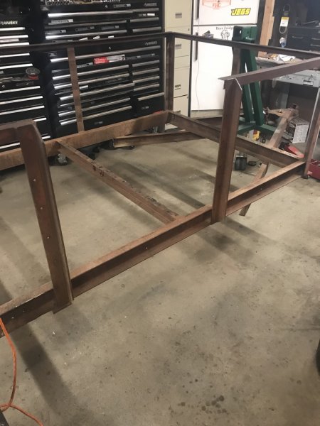

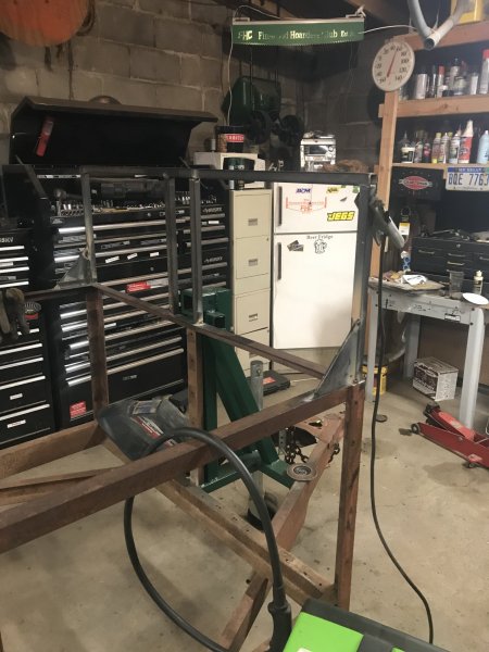

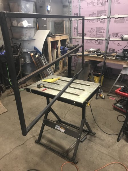

    The last piece a bulkhead It’s getting covered with expanded metal to protect the truck window.
    It’s just tacked right now. I had a heck of a time getting that 1/4” gussets tacked in the corners:whistle:

    with the axles he used he should have about 100 lbs payload left...........
    papadave, Stephiedoll, Horkn and 8 others like this.
  15. Pallet Pete
    13,483
    54,125
    Ovid
    Hasn’t even dropped :D
    The trailer has plenty weight capacity left 7000lb axle after all. :rofl: :lol: I might be crazy :hair:
    Honestly the only heavy part is the back gate it’s a monster the side gate is maybe 25lbs and the bulkhead is even lighter. It’s just 1*1 square tubing.the gussets are 1/4” just because that’s what I had.
