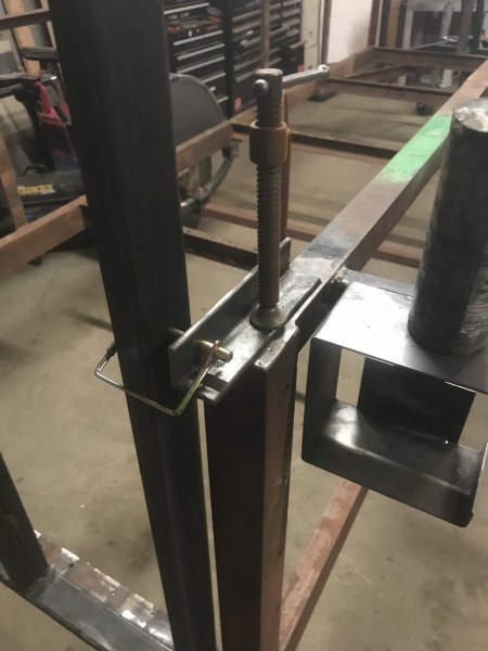

    Mocking up the gate pins. I might make them a little more beefy yet...

    Looking good. Have you got the expanded on the frame yet?
    A cautionary note- You now have penetrations in the tube steel from the latch pins. Consider a few weep holes to prevent water from collecting. A few freeze/thaw cycles can wreak havoc if enough water has collected.

    Very good idea! I was considering lining the inside of the holes with tubing and welding it in but haven’t got anything to use. I might just do weep holes and call it good.

    The tubing (heavy wall) is a good way to go. It will prevent the tube from ovaling out over time.

    That was my thought I was going to use black pipe but I can’t find the pipe I thought I had then thought about tubing and can’t fimd that either.:picard: Might do weep holes anyways just because it’s going to build moisture inside even sealed.
