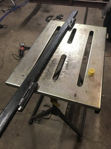

    Two hinges and I am out of wire again...:whistle:

    next time try "notching" the tubing leaving the back connected, then fold the tubing, one less weld and I believe stronger and every thing stays lined up bettererererer........

    also do you use hole saws for fish mouthing tubing, works well.

    That’s a cool idea!

    I’ve got a cheap vise mount for fishmouth cuts somewhere but I don’t really do it often. The whole saw is what I use with it.

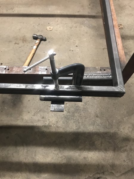

    Well I screwed that up dangit!:picard: I’ve got to move the hinges. O well tomorrow I’m done for today...

    Ok correcting the mistake:headbang: can’t wait till morning it will bug me all night...

    Smooth as butter!
