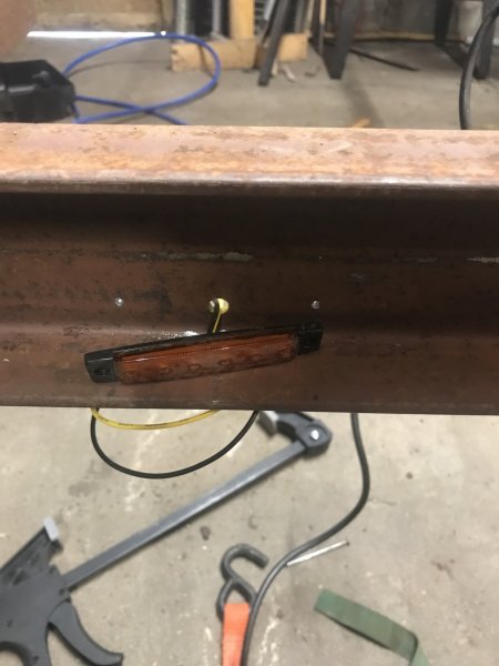

    Pre drilling the running light holes now there gonna look great after paint!

    You might want to consider insulating bushing or some other method to protect those wires.. BTW I bought 5 lbs. of Forney 7018 3/32" welding rods and they arrived today.. Great price and reviews but I haven't tried these yet.. I also bought some depressed center 4.5" cutting discs and they worked great after I added a spacer to the Ryobi angle grinder.. The disc is only .045" thick and the nut wouldn't secure the disc.. I bored out a 5/8" ID flat washer to 7/8" using a Uni-bit and ground 1/16" off the OD with the bench grinder and now they tighten up correctly! Find they cut well and the price is good too.. The flap discs came in but I haven't tried them yet but look decent..

    I am seriously considering emt conduit for the wiring I want all the wires to be individually replaceable so that would be a perfect fit. What where you thinking in terms of insulation Ray?

    Amazon has many choices for grommets.. I would consider PVC conduit so it doesn't rust plus wires are easy to pull and easy to glue up too..

    Love the grommets! I think I will order some tonight! I was gonna use OSI caulk that stuff is like glue when it dries but gromets will be way easier to remove later on!
    Problem with pvc is I’ll destroy it in short order:whistle:
