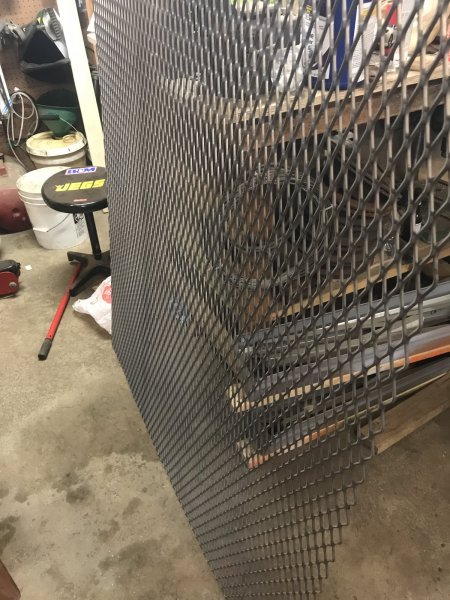

    Well I ordered 24’ of 1*2 11 guage and 3/4 #9 mesh I’ll double up the 1*1 for the rest.

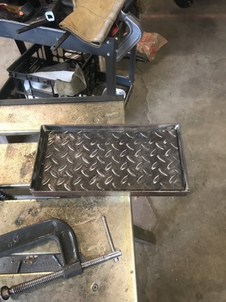

    Plate holder in the works some old dirty metal and a grinder is perfect!
    No more bent plates!
    I want it behind the left fender but I’m not sure if that’s legal so it’s getting welded either under the back or on the ramp with a light

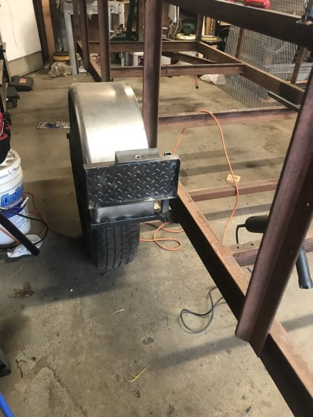

  9. Pallet Pete
    Pallet Pete Moderator
    13,483
    54,125
    Ovid
    Eah screw it why not my friend does has his trailers setup this way so why not. I also have a light for it.

    Got the light holder mounted too the top of the plate holder.
    Ain’t pretty but it’s functional!

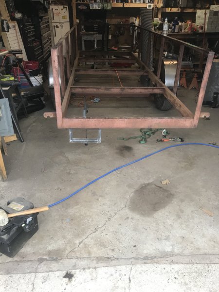

    Light cages getting welded on now man they look good!!!

    Also picked up expanded steel for the gate today.
