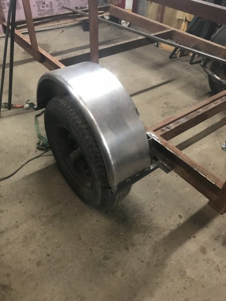

  12. Pallet Pete
    Pallet Pete Moderator
    13,483
    54,125
    Ovid
    Both fenders are on now! I messed the alignment up a tad but o well.
    Gasifier, raybonz, milleo and 7 others like this.
  13. Beetle-Kill
    Beetle-Kill
    Nov 23, 2013
    4,102
    19,559
    Near the Divide, Colorado
    Nice job on the winch mount, it's all coming together nicely. :yes:

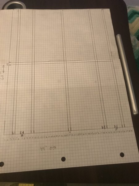

    3/4, #9 flat expanded would work if you haven't found something yet. Or #3, #4, or #4.27 walkway grate. But it gets heavy if your ramp is big.
    Horkn, Pallet Pete and WeldrDave like this.
  20. Pallet Pete
    13,483
    54,125
    Ovid
    dammit I think I screwed up:headbang: I meant to buy 1*2 11 gauge for the ramp gate instead I bought 1*1 11 guage and cant take it back.:picard: That was reallllllly stupid. I’ve got 68’ of it now. I have a couple long sections of 2*2 angle I can weld on the outside runners and I can double stack the center support that way
