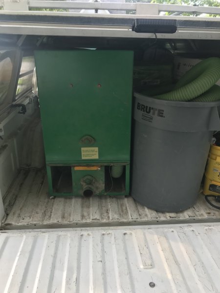

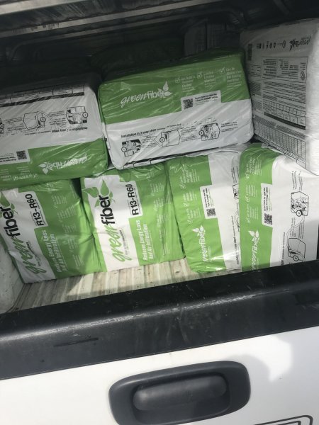

    H-O-L-Y cow that sucked!
    It took roughly 2 hours to fill 225sq ft that must be the most gutless worn out insulation blower at Home Depot.
    I crawled in there with hose a flash light and a stick taped to the hose. I almost couldn’t crawl back out! :rofl: :lol:
    BUT it’s done and looks pretty good! I fit 30 bundles insulation a blower and bucket with hose in the bed of the truck. o_O

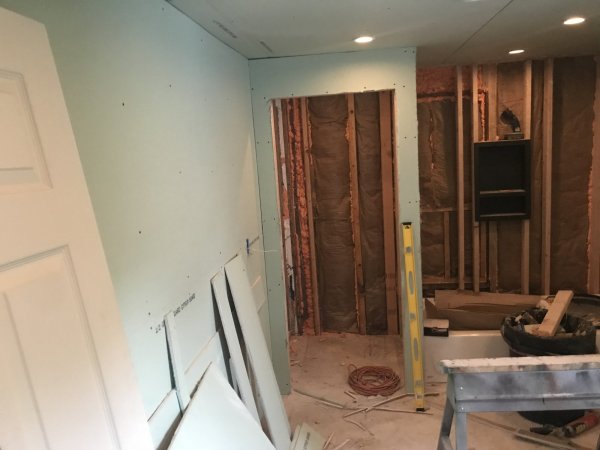

    No vapor barrier on the drywall areas. Where we did have a barrier was the worst mold. It did no good at all in this house and that was the one thing they did correctly go figure...
    The cement board is all getting waterproofed with roll on sealent under the tile. It’s expensive but totally worth it...
    Here’s the progress so far! Taped last night and doing the first floating today.

    Looks pretty good.
    What type of cieling light did you install?
    Every light fixture i replaced I went with LED lights.
