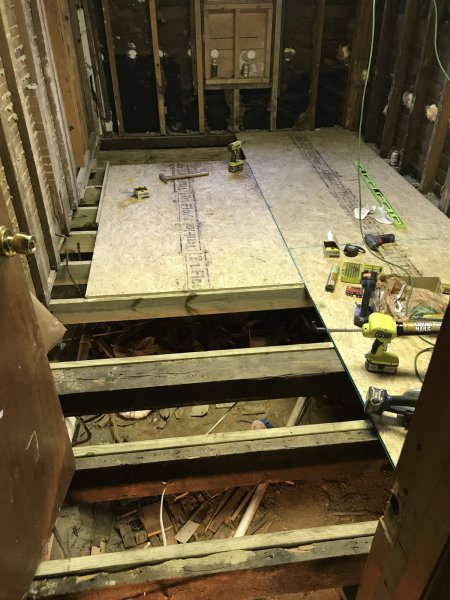

    If you insulate the floor will you deprive the crawlspace of any heat which may be keeping things from freezing now ??

    Most of the joists are replaced however the last 4 couldn’t be removed and are solid so they got sistered.
    No the furnace is downstairs and had a vent for the basement. Even with the woodstove only it’s warm enough. I actually think the insulation will help the basement not hinder.
    We had frozen pipes a few times in the past but that was due to a poorly designed access door and somebody attaching the old plumbing directly to the door. o_O Once I figured that out and sealed it then moved the water lines we didn’t have any more issues.

    I had help show up yesterday right as it got hot out. Didn’t get as far as I wanted but we definatly got farther than we thought possible.
    The floor got heavily modified, jacked up and anchored. If it ever comes apart again the house will be on the ground!

    Thats a very good possibility the insane amount of flooring layers didnt do anything except cover up mold each time. I am in the nuke-it process mold be gone poo be contained and all that jazz.:dex:

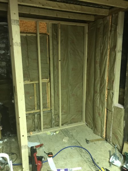

    Getting there on the shower. I had to replace 4 studs that where falling out and re support a bunch of the others. But it’s coming together nicely! I’m not done with the back stud wall yet that will be finished tomorrow night. It was much easier to go that route than try to even the studs out. They where insanly far off. The wall isn’t even close to square with the wall on the right so easiest fix was a stud wall.
    The big shock was the cost of insulation that’s gonna rob the bank! We bought R30 rafter bats and will be blowing in on top of that to try to get to R40 in the ceiling but there may not be enough room. We will cross that bridge when we get there. Anything is better than the R13 wall bats they had as ceiling insulation when we did tear out.
