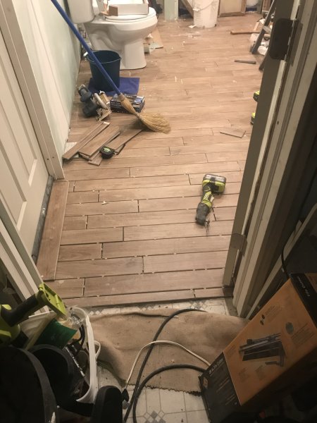

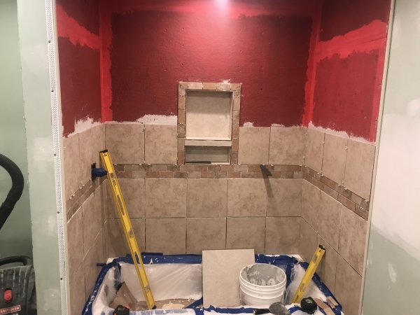

    Well due to some issues I haven’t been able to get to the tile until this weekend. Hopefully by the end of tomorrow the shower and floor will be tiled all the way. The floor is cut out there is about 4sq ft left to mud there. It’s lookong pretty good.

    I dont know who is more anxious to see the finished product. Us, or your neighbor who's shower you've been using!
    :rofl: :lol: looking good Pete!

    :) It sure is looking good.
