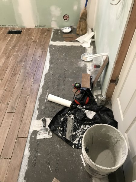

    Well I’m done for the day.
    Had to switch the trowels for the cheapo it works way better than the fancy one I bought of the same depth.
    I have a lot of mortar through the grout lines more than I want but it’s cleanable so o well. More work but worth it in the end.

  5. papadave
    We keep a carpenter pencil handy to get excess mortar from between the tiles as we go.
    mat60, savemoney, wildwest and 5 others like this.
  6. Pallet Pete
    Pallet Pete Moderator
    13,483
    54,125
    Ovid
    Thats a gooder Idear!:thumbs::thumbs:
