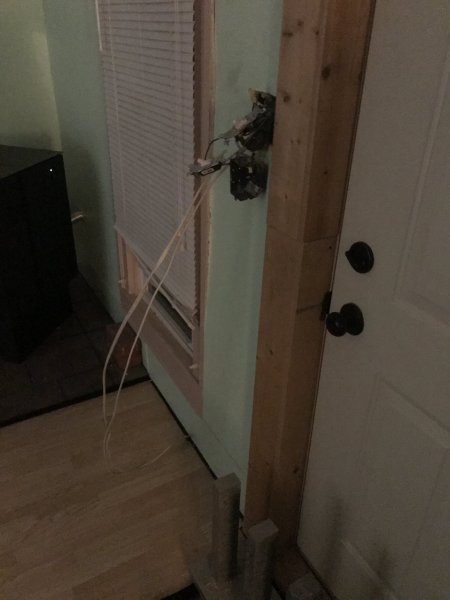

    That SUCKED! Took Half the day fish those two wires through the wall but there there now.. It looks like we can run more than first thought but it’s gonna take most of a day for each section.... :picard:I do wiring for my job among other things and this makes me glad building codes are a thing now:rofl: :lol:
    The walls don’t have any semblance of uniformity in them. We where about to give up when I cracked a beer and sat there looking at the hole then took one last shot at getting the fish tape through and it finally went through the wall...
    There’s 3 yes 3! Horizontal boards between the door and window as well as 4 vertical boards... :loco: :crazy: NOT evenly spaced out at all...

  2. billb3
    9,817
    50,406
    I used to fish wire.
    As much as I hate painting, that wall would probably be new sheetrock now.
