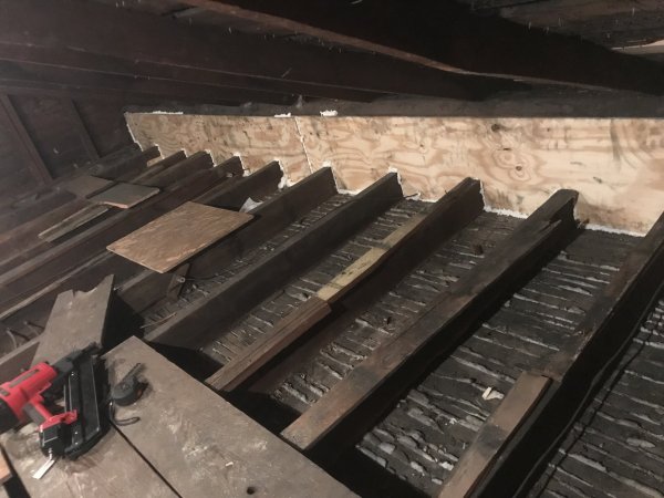

    Found time to get the second half in tonight. Pita that was.
    Getting what wire I can pull ready for Sunday. That’s the big day to get wiring done... I hope...
    Foamed the snot out of the boards I figure that will help keep rodents out and act like a glue. OSI foam is tuff stuff! It ain’t pretty but it’s stuck now..

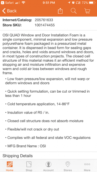

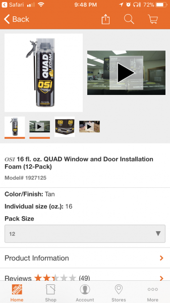

    I’ve also found OSI quad foam is WAY better for air sealing than great stuff. It’s what I have been using before the foam gun and now with the foam gun.
    The OSI quad caulk is also superior to anything else I’ve ever used...
