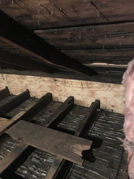

    Looks like it’s off to Home Depot I need to do some work covering up a nice big opening into the porch roof.

    Now you are just stalling......................nice clean up job
    How many times have you stood up and gouged your head on all those roofing nails sticking thru

    Spent some attic time myself yesterday...didn't aerate my head, but those danged nails did snag my hat off a couple times...o_O

    Could they have used roofing nails that were just a tad longer ?

    Some are 3” framing nails but theve held up this long so I guess I’ll live with it..:picard:

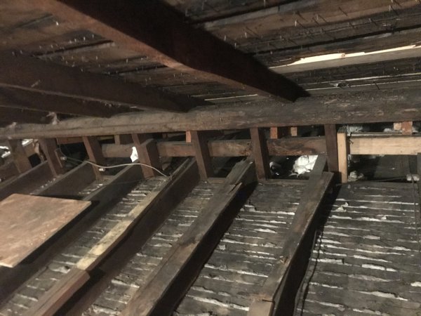

    Well my friend a contractor looked at this mess and advised me to not strengthen the roof because the porch side does not all sit on the wall but is actually nailed to the studs on half of it. The back is on the wall but the wall is not strong enough to handle the extra load.
    Basically he said it’s stood since 1800’s don’t mess with it. :whistle: The side effects of snow load being diverted to areas that where not meant for it are bad. He has done a lot of older home remodeling and says that is always a problem that causes more problems. :hair: Man that isn’t what we needed to hear....

    :rofl: :lol:We had similar at our previous home on the covered sun deck (complete with 3" nails sticking out underneath!), the cedar floor was poorly attached to the joists in the house and the roof continued from house to end of deck supported by the deck frame. There were telephone poles under there but the deck floated a couple inches above them :eek:. We did however change it up, we had to for both building permit & inspection though when we put a cement tile roof on that was heavier than the asphalt shingles.
    Sorry about the bad news on making a new snow paths. This funky old house is, well funky, but it's withstood common hurricane force winds for like 70 years, so we're leaving most of it alone too.

    I think the 3" spikes are left there from the roofers using roof jacks...I know I didn't 3" spikes sticking through until after the last reroof...the roof jacks are the only reason to have used spikes...probably easier (and faster) to drive them in and leave 'em than to risk pulling them out and breaking a board in the process...
