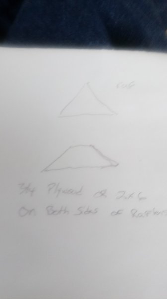

    Looking at previous pics looks like a 1 and 3/4 home top floor about 5 feet up is roof pitched?
    I was suggesting collar tie peak 0127181447.jpg and depending on wall beneath a carrying wall towards middle on each side to remove sag.

    triangles are the strongest building shape, one side can not move unless another side moves. so if the one side of the triangle sitting on the beam wants to move it has to move the other one going up to the roof on the other side, transferring the load and increasing strength.
    think about a roof truss, you could actually build one using the existing rafters and ceiling joists if they lined up, this would remove all the load off the ceiling.
    again I would go with a collar tie as VT drew a piece of 3/4 PLYWOOD cut to fit then glued and nailed or screwed to the rafters, that should stop all movement, be the least work and the least intrusive. 16" triangles and you could get 3 rows out of a sheet of plywood probably about 12 triangles out of a sheet.

    Yeah I always use a piece of cardboard with a pair of scissors and cut to make the template. I put two pieces of 3/4 on each side of the rafter and then tried to put a 2 by between it.

    wow you related to OVERKILL (Scotty), one piece on each side will do.

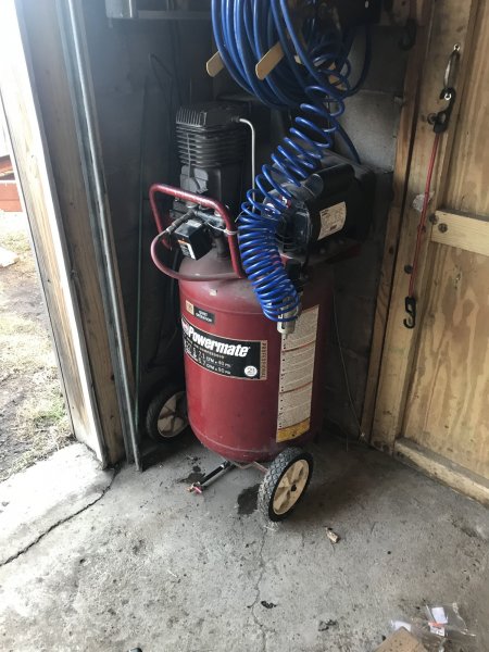

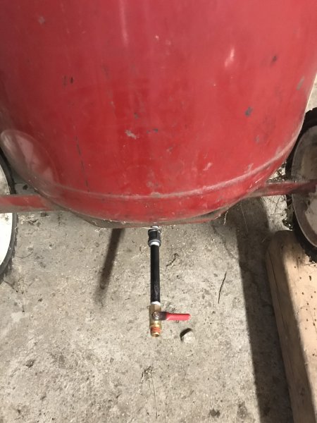

    21B93D01-23BA-4A27-994C-C5D54AE2420D.jpeg Sorry guys took a little break from the attic to do a small drain mod on the air compressor...

    I need to do that on my tractor's oil drain plug.

    That’s what I am doing to the air compressor next time I change the oil that extension is a back saver and the valve is way easier than the screw cock it came with!
