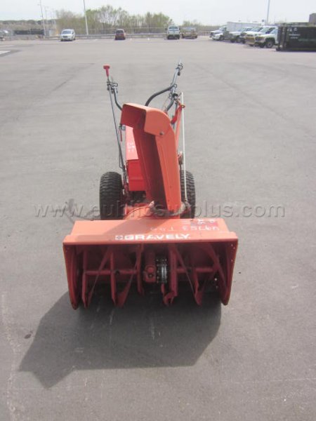

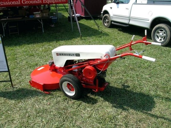

    I'm an ATV and plow person. We don't typically get enough snow for this combo not to work - Northeast Ohio. If it gets too deep, then I get the tractor out.
    That being said, I would maybe look at an old gravely walk behind. They are easy to find and can be had rather cheap. Plus you can use it in the summer for a million and one other uses. I have a few of these units and a snowblower but never blow snow - I just mow and till. These units will last generations and are STRONG!

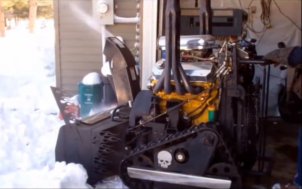

    Oh, look at the youtube stuff :rofl: :lol: "V8 snowblowers"

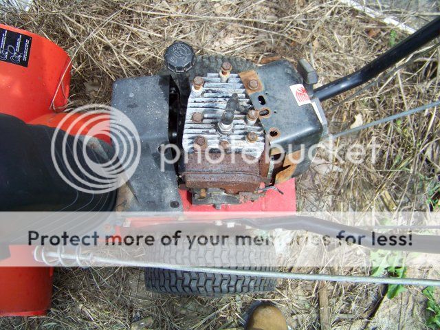

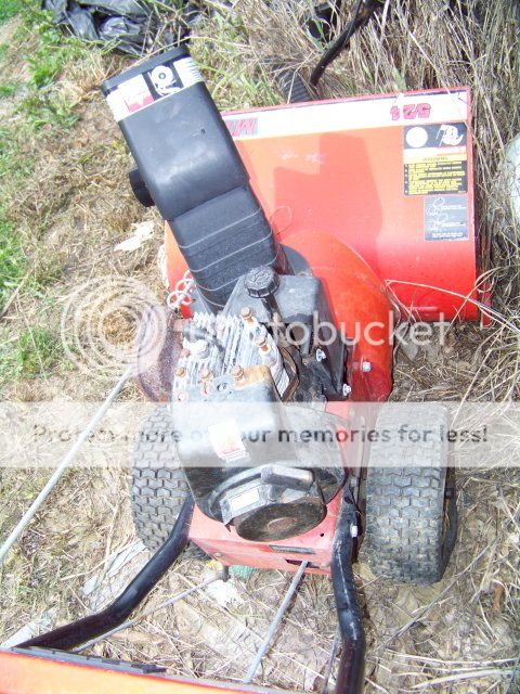

    I picked this MTD up from beside the road. Lots of motor parts missing and tires weather checked and flat.
    Other than what you see it was great shape. I bought a Harbor Freight Predator 6.5 HP 212 cc's for it. Hooked perfect to the blower impeller. I drilled holes in the impeller vanes and installed semi mud flap chunks of rubber to them. Put a pair of TSC tires on it and I have one fine blower I leave at Mother in laws. It will blow slush a goot 15 feet and dry fluffy stuff a good 4o feet.
    I bought a new end of the season Snow Tec by Ariens for here at home. does a fine job on the gravel drive. You adjust the skid plate so the wear bar runs about two inches off the gravel. I also use the lawn roller on the drive in the fall when it is wet to push any thing above 2 inches down.
    It has a plastic chute same as the MTD and they work fine. If the snow is slushy I do coat the chute with dallor store cooking spray.
