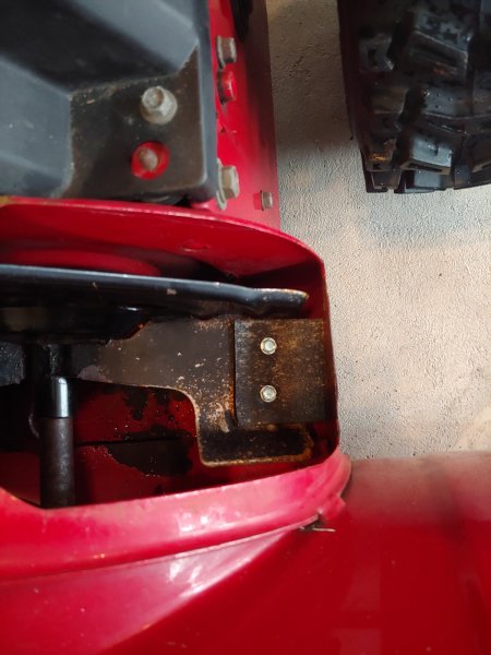

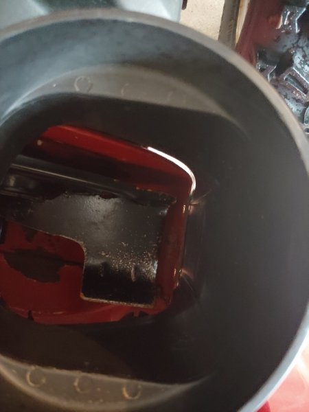

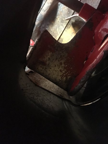

    I'm excited to see if it works.
    Before with a half inch gap.
    After. I did a dry run. It does make a bit more noise but I sprayed it down with fluid film. I have a 3 propeller? So I did all 3. Mine were pretty thick so I predrilled before I sank the self tappers. Thanks again Pallet Pete !

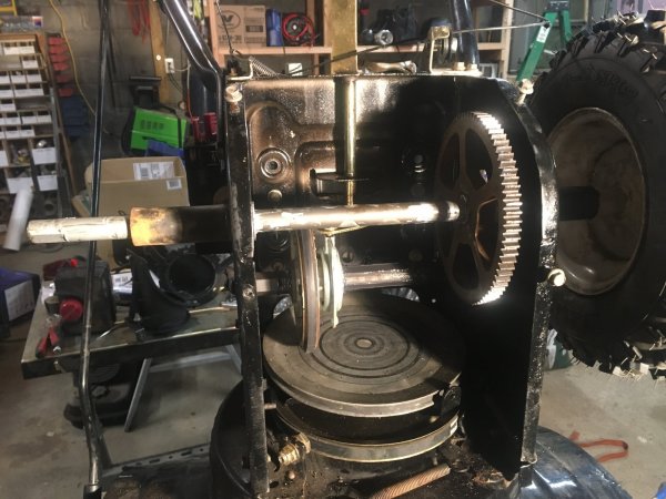

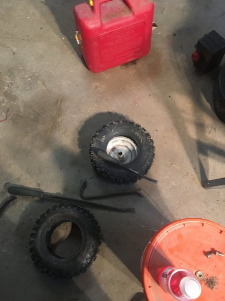

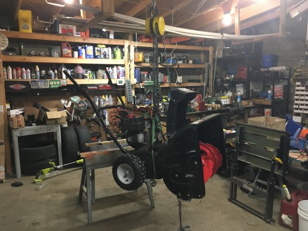

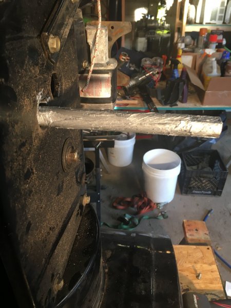

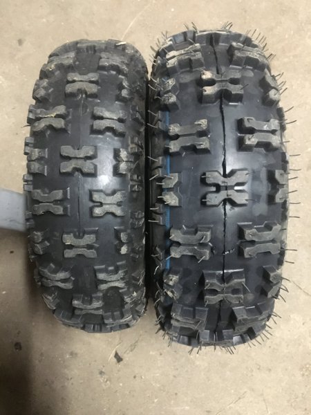

    I took the axle out completely and went nuts with a grinder talk about RUST! Not anymore it’s clean as a whistle... Then in my ocd style it got an insane amount of anti-seize. It WILL come apart easy next time! :rofl: :lol: That was absolutely insane the rubber mallet turned into a hammer then gear pulled before I got the dang tires off... They where off last year for grease but that obviously failed.. :wacky:
    The belts are replaced and suprisingly everything looks really good! A little surface rust but nothing bad.
    The impeller mod happens tomorrow there is enough junk in my garage that it should go together pretty easily after removing the side access for the impeller. And let me tell ya there is way more space there than I thought between the wall and impeller! A good 3/4” in some spots....
    I changed one tire then of course got distracted so I’ll finish tomorrow. Here’s some pics
