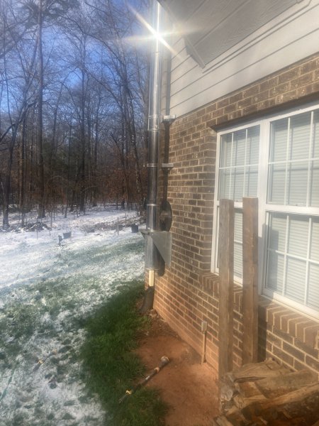

    I the same problem but only when the chimney is completely cold. Here are some ideas.
    • Wadded up newspaper (works eventually but results in lots of smoke in the room)
    • Propane torch (I probably didn't leave it going long enough)
    Here are 2 untried ideas
    • Put a small heater in the firebox and let it run for 20 minutes to heat up the flu
    • If you have an external chimney like mine take the bottom cap off and run a leaf blower up it.

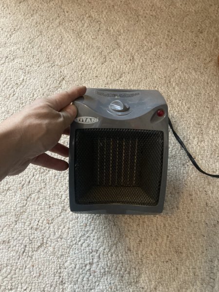

    Heater with a plate to stop the ash coming out works everytime...5.min...if you have and abuer flue probe you will see how cold air drops in your chimney...

    I do that. I have a flue clean-out in the basement. I slip the cap off and slide my propane torch in the snout with the flame pointing up the flue.
    Works perfect.
    The OP may be able to put the torch in the stove pointing into the flue outlet.

  10. Paul Dokken

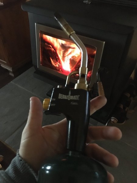

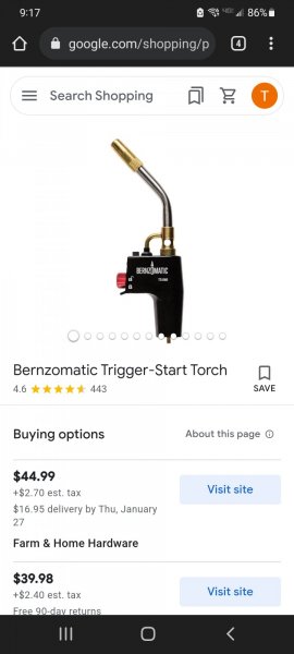

    NorthWoodsBG, Highbeam, TurboDiesel .....can someone post a pic/info of the propane torch you're using to warm the flue/start fires please? I've had one of those that use the blue bottles that was partially plastic, and melted part of it starting a campfire last year (left it propped to start the fire too long while I moved something... obviously all my fault). If I get another it will be the totally metal head, unless yall suggest something different. Not sure if you can refill the blue bottles, or just the green? Are the torches threaded for specific cylinders (size, style, if color denotes anything...)?

    The torch pictured is the ts 4000 ( i believe) which is the best one I've ever had, no adjustable flame which makes it very easy and predictable to run.

    Yes, they thread onto green bottles. That's what I use. I have the adjustable flame ones and I regularly adjust the flame for fun I guess. Sometimes you want a slower start and high flame is pretty loud. It's also a little harder to start at high flame.
    My torch was from home depot and came with a yellow mapp gas bottle. When it ran dry I replaced that bottle with one of many 1# green LPG bottles and I'm a happy camper. 49F34939-C3BC-438F-BF9E-8CD907186450.jpeg
