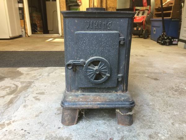

    I saw this on CL tonight and though of this thread. I don't know the dimensions.
