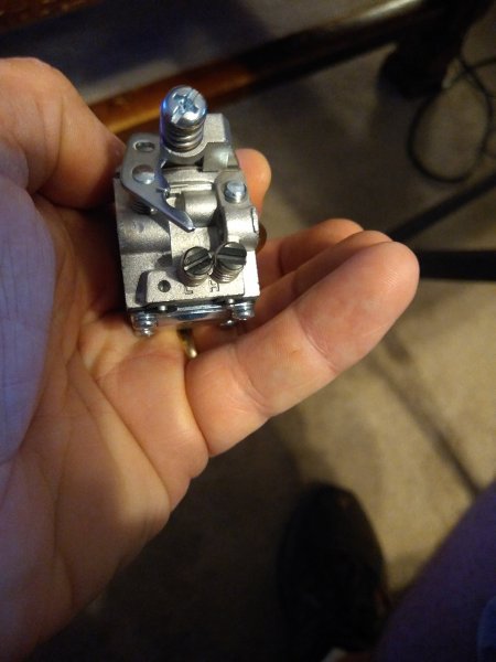

    Nah he didn't straight gas it. Has fresh gas. Something is wonky with the carb after I was messing with it. I primed the carb, was a really hard start. Wouldn't idle after getting it running I had to hold or blip throttle. Out a ton of marvel mystery oil in the tank. I think it may have loosened something somewhere cause it started to then lean out...or it was just there was so much oil in there that it had less fuel and without a real adjustable carb I can't fool with it.
    Got on eBay last night and found a fully adjustable carb that claims to fit the 170. It needs a new carb or a rebuild. I have had good luck with the Chinese replacements and they cost just as much as the kits or less sometimes so went that route. In my big saws I will rebuild them but these smaller ones and weed eaters I have just been replacing them. I'll keep you posted when I get it in. Probably start my own thread as to not totally hijack this one.

    Carb for the 170 came yesterday. It says it fits. It's fully adjustable. I have heard these existed for awhile so I am sure it will fit. Will install it today or tomorrow. At some point I probably will muffler mod it as well to get more power.

    I replaced the carb. Was all wonky still and couldn't tune it. Went to go out more fuel in it and it was full of milky colored watered down gas!! I'm sure this was the issue the whole time. I asked if he left it in the rain. He said no I asked if he used ethonol fuel cause if he did it probably sucked up moisture and the watered down fuel sinks and when he adds gas it starts all over and if there is not much left it's all now low grade watered down fuel.
    I dumped it into a cup and then put fresh gas. It runs a bit better but still a bit odd. Maybe some water still in it..maybe it's scored? It might have bad crank seals as it bogs and stuff as you move it around. I'll get it as good as I can and run it till it seizes. It's just a throw away 170.
    Now what had to be done. The top of the carb has to be swapped with yours. You have to drill holes into the side to get to the adjustment screws. It's not a hard mod though. IMG_20210820_184739524.jpg
