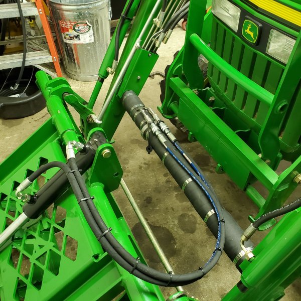

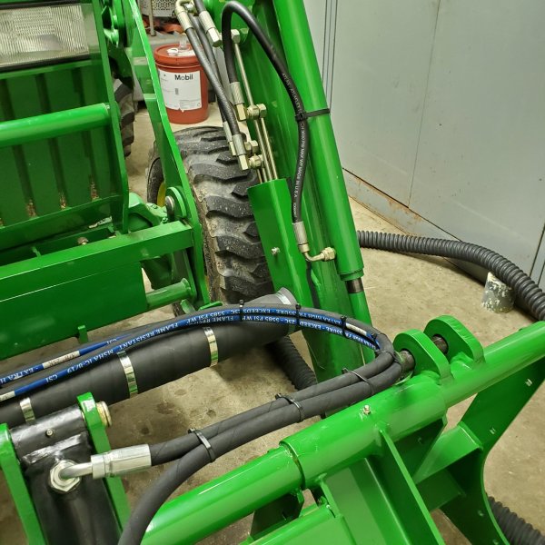

    I did say I'd be slow...
    Only progress has been to finish the line covers, and to replace a hose that I totally buggered measuring for.

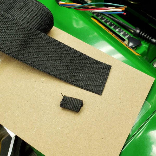

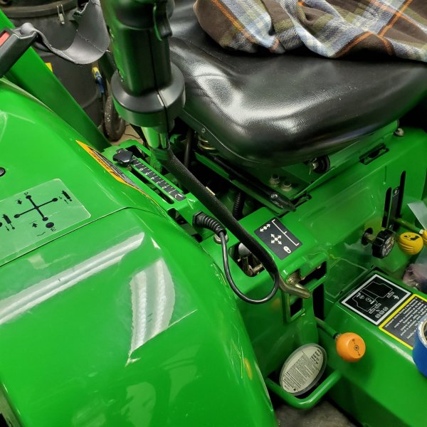

    Drilled the hole for the strain relief in the 3 point control bracket, and yeah I painted the inside of the hole.
    I found some abrasion resistant heat shrink webbing and used it for holding the cable to the joystick.

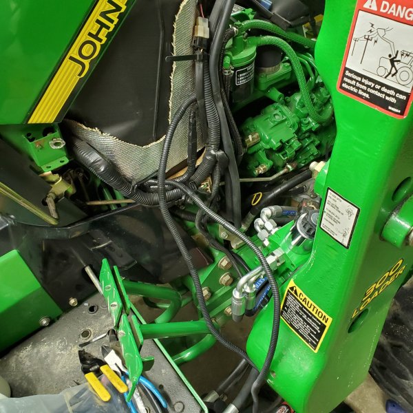

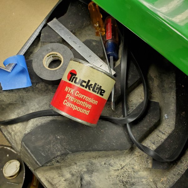

    Got the wires up to here at least
    The first weekend I owned the tractor I undid every electrical connection and packed it with this stuff. That was 12 years ago.

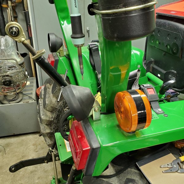

    Just finishing up the wiring. Thought I'd post a picture of my electric taillight perforator.
    Chvymn99, Chaz and Gasifier like this.
  8. brenndatomu
    25,246
    164,312
    Do pray tell, why would one desire to perforate his posterior illumination housing?

    I mistakenly thought it was a anisotropic cavity and I was just trying to release some trapped photons as I'm a total believer that all photons should be able to roam free from captivity !!
