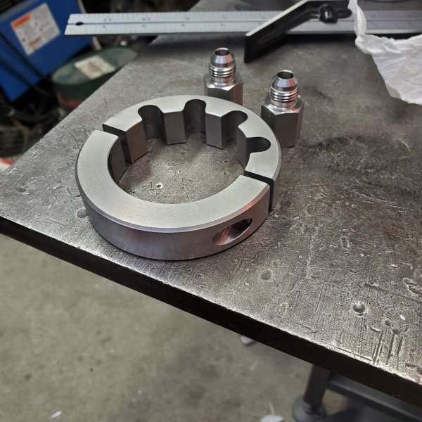

    I'm using 316ss so I can weld the 316ss JIC-NPT adapters to it. Then like a shaft collar it will clamp to the loader crossmember. 20200121_195642.jpg
    So I picked up the hoses yesterday.....I'm thinking I'll be able to sit by tomorrow.

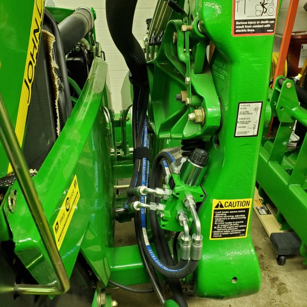

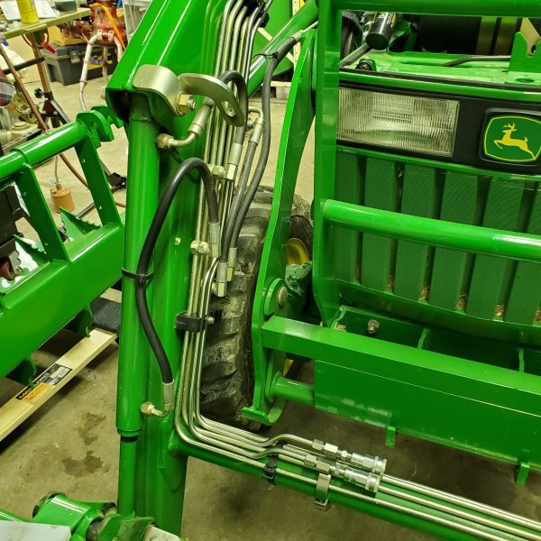

    20200123_174911.jpg 20200123_174817.jpg tonight's progress. Bled and pressure tested the de energized circuit, no leaks so far.
    My daughter should be getting the last hoses made tomorrow. She'll be oh so happy.......
    Tomorrow I will weld the fittings to the collar, it's just hand tight now so I could measure the hoses.

  15. Gasifier
    20,495
    104,020
    Great job!:yes: Looks factory.:thumbs:Now you are going to make me clean my 310J. Well, after I get done moving all this dirt. I couldn’t help but notice you can actually see all of your tractor.o_O I’m going back to moving more dirt today. Can’t wait to see final pics and see you moving something with that grapple.:popcorn:

    It's not always that clean !! I tend to be a bit OCD when I open up things like hydraulics. A little dirt inside goes a long way........
