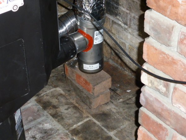

  3. PelletHound
    PelletHound

    Thanks Jay.Pictures of my beast.
  4. PelletHound
    PelletHound
    Oct 4, 2014
    886
    5,330
    SE Ma.
    Fancified Tee holder upper.

  15. Lousyweather
    Lousyweather
    Dec 23, 2013
    2,798
    9,040
    hmmm....I like the fact you went to the extra effort of putting a noncombustible panel in front to satisfy the 6" clearance spec, good on you for that, buuuuuutm man, that exhaust pipe connection isn't exactly secure......lots of goobery rtv isn't the right way to connect to a liner,,,,Id mention THAT to the installer as well
    wildwest likes this.
  16. PelletHound
    PelletHound
    Oct 4, 2014
    886
    5,330
    SE Ma.
    I made that panel out of 1/2" cement board and 16 gauge cold rolled steel.The building inspector was impressed.Here is a better shot of that dodgy tee. P1010463.JPG

  17. DexterDay
    DexterDay Administrator
    12,411
    31,637
    Northeast Oh
    Is the red RTV used to seal the factory seam?
    I had to do that on my Quadrafire install. Some of the Pellet vent pro seams were a little leaky..

  18. PelletHound
    PelletHound
    Oct 4, 2014
    886
    5,330
    SE Ma.
    I bet there all leaky and that's why they sealed it.I fired her up today and didn't notice any smoke.

  19. don2222
    don2222
    Nov 10, 2013
    3,444
    4,892
    Salem NH
    Hello
    Insulation in gaps does not cut the mustered! They need to take the plate down and install a good layer of 100% fire proof Roxul insulation above the block off plate to stop the heat converting up thru!
