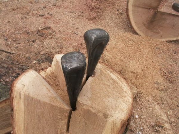

    A non operational hydro splitter is not helping me now. Good thing I work for a hydraulics system integrator.

    Are your wedges square or cone? I have two cone-wedges. One is like a star, the tip was twisted and makes it easy to just pound in amd split. Most square ones are best for when it has started to split and just needs the help. Don't work it too hardcore, you splitting is already a good man-card deal. You can't lose that. :D
    I find the round wedges do really well for me when I have a knot-laden round and it's becoming a bear to split since it becomes stringy and whatnot. They get stuck but that's where multiple wedges work.

    Just using a square wedge and putting a lot of muscle on it. It will not go in no matter how hard I hit it. Just gonna start with the saw and draw a line and pound the wedge in. EricVW was right... Might get a cone too, but a little afraid of the shrapnel. Absorbing the advice...

    That's the way I do it, I have bounced too many wedges out of the big stuff.

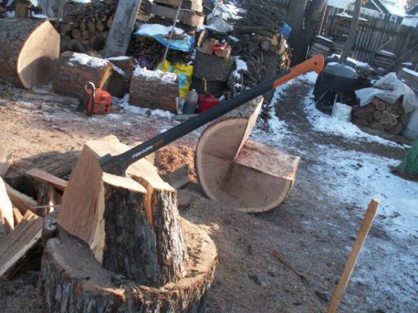

    Red oak Mike. Some split well, but lots of odd grain from old branches in the big rounds. Cheers!

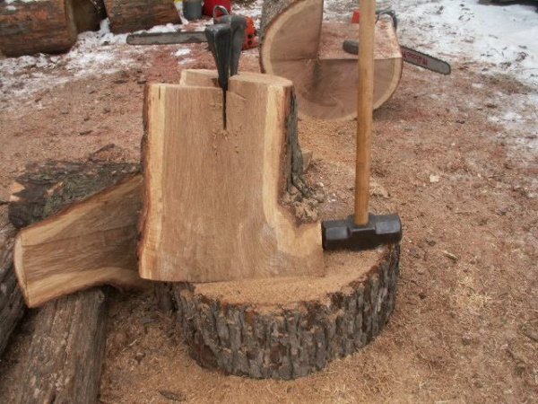

    Yes, the wedges do want to bounce out - setting them can be tricky. I use my maul to strike several deep impressions where I want to place the wedge - then use a 2lb sledge to set the wedge a 1/2" or so into the impression. Then a few half swings with the 10lb sledge to set the wedge deeper and then start full swings to drive the wedge. Cheers!

    Multiple wedges are a must - you'll inevitably sink a wedge and it will be, well......wedged! As you open the crack with the second wedge, you'll loosen the first, and so on. As you start to mushroom the top of the wedge, be sure to grind off the mushrooming steel - at some point you'll strike the head and send off a piece of steel at high velocity - perhaps right into your face - not good. Safety glasses are a must. Good luck! Cheers!
