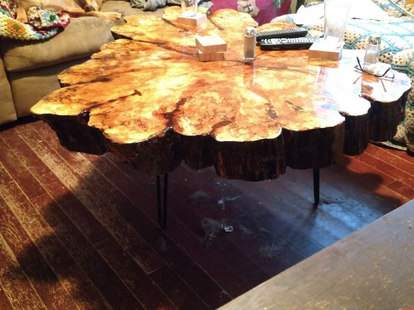

    I had decent luck with anchor seal. Coated both sides and left outside on a pallet for the first two years.
    There is polyethylene glycol Wich is supposed to be better for cookies. A serious wood stabilizer from what I've seen, Which I will be using if I do it again.
    I'd be worried with attaching boards as the wood shrank it would make it crack.
    I cut my cookie with several extra inches for (to try and mill out)checking and splitting. Then used a "router sled" to level and thickness it.
    This sugar maple I did this summer is 53 at it's widest

    Nice looking table there! But I can hear it already...."Honey, can you move this table for me?"

    Boomstick that table is absolutely beautiful! :dex::thumbs: The only thing that sucks is the long wait for it to be just right so you can actually built it!:hair:
