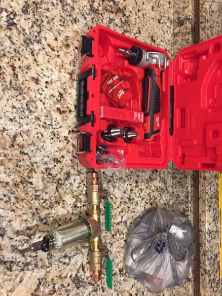

    Got all the materials in but they screwed up on a couple tees and sent me a couple 1/2x3/4x1/2
    Instead of the 3/4x1/2x1/2 that I ordered for the kitchen sink and washing machine branches.
    Should have all the rough in done tomorrow then do a final hookup sometime this week
    Little tool porn

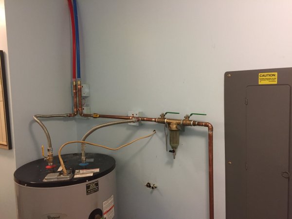

    Got everything rerun and hooked up today- no leaks!
    Took the opportunity to add a whole house sediment filter though I doubt it will matter now that the garden spigots are isolated from system.
    Realized I was gonna be short on 3/4 copper to do it like I originally planned so I dropped the PEX supply next to the water heater- came out decent need to cover them with insulation for uv protection.
    I’ll post some pics tomorrow after my knees recover.

    Rerun of the supplies:

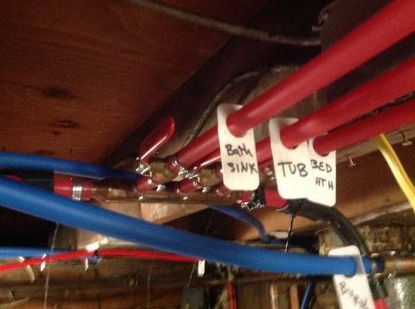

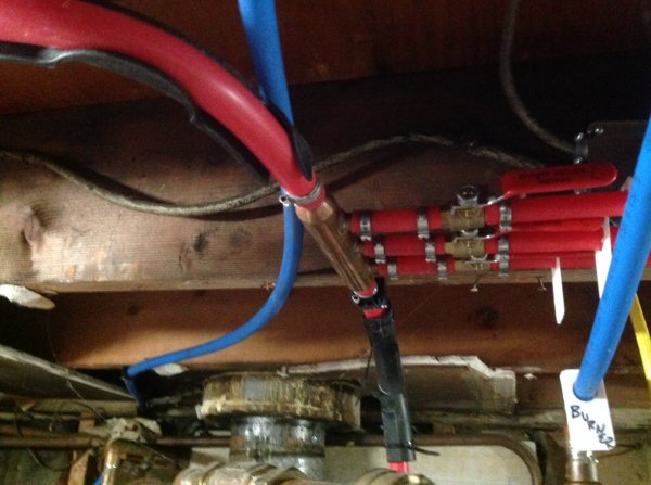

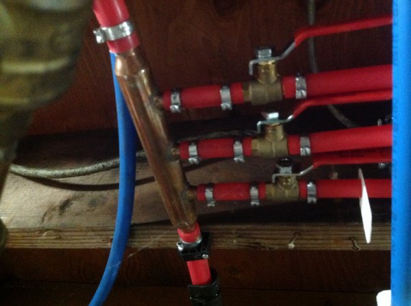

    Redid plumbing hot/cold at my Moms and sons house using pex. Added manifolds and shutoffs, soldered adaptor to copper pipe- used stainless crimp rings worked great
    Ordered all fittings and pex online and had them in a few days.
    Way cheaper than box stores and they had more fittings
    Here are the two places I ordered from.
    SupplyHouse.com
    pexuniverse.com
    and some pics
