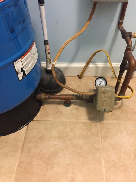

    The well supply comes up tees to the left on receiver tank and right towards switch. Cold supply tees off to the right and goes under the slab the water heater supply is the upper valve- they both have blue handles I replaced bonnets on both of them last Saturday because the cold was missing the valve seat screw.

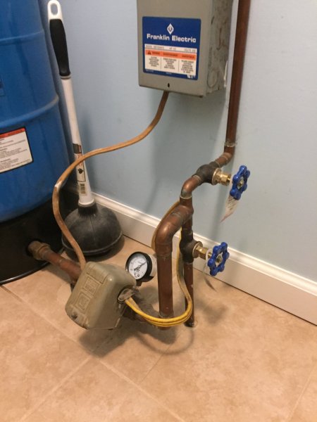

    Another pic supply tee and switch.
    I’ve run toilet dye tests checked all outside spigots. Tried to replace upstairs shower cartridges, couldn’t find them but installed new orings. Receiver was charged at 28psi 30/50 switch.

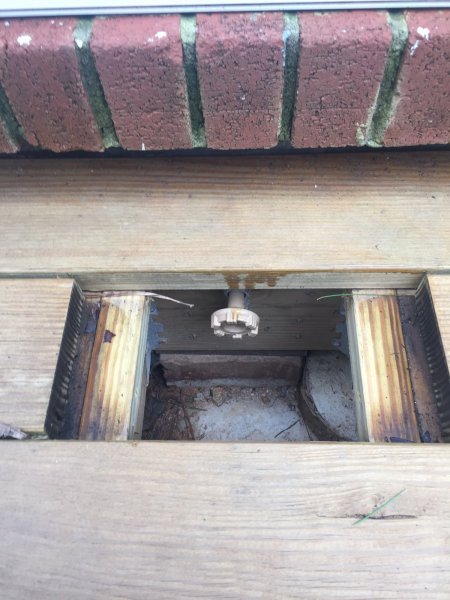

    With my stethoscope the loudest leak point is at the spigot coming out under the deck. It’s a new frost free I installed when the deck was replaced in 2018.
    There isn’t any obvious water leaking near it but everything is saturated here from the 15+” of rain we’ve had this February

    16,054
    95,675
    Sounds like you found it...kinda...
    The biggest problem with the Frost Free hydrants is people forget to disconnect the hose. They freeze from the outside in, then burst inside letting the water leak inside where you may not see it.
    I had an elderly lady go out on the cartport and spend an hour cleaning lawn furniture only to come back in and find her kitchen and basement flooded because the hydrant burst inside the kitchen sink cabinet.
    Of course they dont (usually) leak until they are turn on...

    The hose was disconnected back in late fall before the first frost. There’s not really a good way to access it now that the deck is done. I had to remove bricks made the NPT connection outside and then sweated the valve body with guts removed. It was under pressure for several days before I sealed up the remaining void with great stuff
