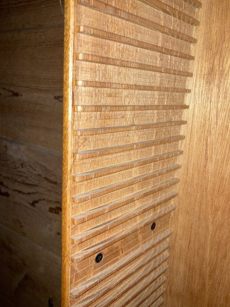

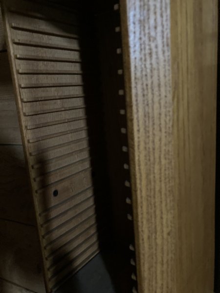

    I built something similar many years ago when I was into woodworking. Called it my radial arm router. Built on one of those old heavy metal office desks that was already in the basement taking up room. Sled rides on 3 angle irons sandwiched together so there’s no up and down play. Only have a 1hp plunge router in it. Made multiple height adjustments the sled system can be moved too.
    I made it for the purpose of building CD racks, back in the day when CD racks were a thing LOL. You could at that time buy plastic inserts but I thought that cheating. A Dado bladed on the radial arms is too rough to cut slots with so little raised wood left. So I built this machine,,,,,even thought about going into business selling them. I built two, still have one.
    I was making them from red oak floor boards that were free. Planed down to 5/8” and screwed and glued together to give it some thickness not seen in Walmart CD racks. Even built an adjustable jig that indexed off the first cut to make everything perfectly in line, pencil marks and rulers would never work. It worked very well. Could flatten boards with it too. Maybe put my big router in it for that.
